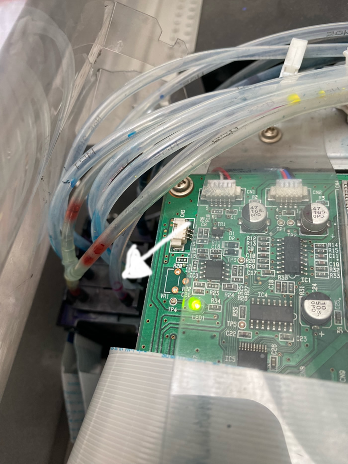

Thanks Netsol. I took these pics today showing the head and captop is indeed new. I get no ink on my finger touching the black head surround.
What's confusing though is this shows the system was drained and then the new parts fitted so no test print was done. The work was carried out on 20th Sept 2022 by the way.
Netsol do you have a link to the pump/syringe i would require to try and pull the ink through, i think ill try this first.

Had a closer look at the pipes. Looks like gravity is taking the ink some way but not very far.
Flush and then manual pump?

I don't really think there are silly questions. To answer your question, it wouldn't be those lines you'd connect to but rather the ones after the cap top, which is the part the head sits on. You'll need to remove that cover around the cap top to reach them, as well as reach the pump.
SteveHem
I see, so would (hopefully) the syringe will pull all ink colours all the way to the head through just one of these lines? and i carry on until these 2 lines have ink in?
Also is that the pump the lines go into on the pic?
Yes, in a perfect world. but, if you have luck like mine, you may have to CAREFULLY turn the small nut on each damper with something like a small ignition wrench (something like 7mm. remove the line, without losing the small oring. allow the syringe to pull ink. reconnect the hose to the top of the damper and CAREFULLY TIGHTEN. move on to the next line.
when we changed the heads in my sc545-ex about 4-1/2 yrs ago. one of my employees was convinced we had bad air lines, bad orings, bad captop, the new heads were no good... could not get ink to pull through for the life of us. long story short, after pulling ink through we have been printing for 4-1/2 years and never had to change the lines, orings or anything else. when pulling ink through these machines are very stubborn.
wait for the handheld pump. i think you will be amazed
