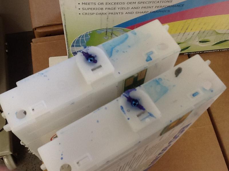

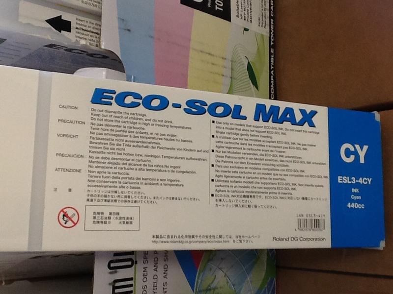

It was leaking where the cartridge is inserted into the machine. Had a Roland rep come look at it today. All lines where secure and no leaks after cleaning it or during a print job. One thing we did find is the cartridge is way different from the other cartridges with only a foil cap( the others have a plastic cap for the needle to go into). This is a factory cartridge and not an aftermarket version too. We are waiting for new ones to show tomorrow so we can check it out.
Foil? Yea that's weird. My gut thought was the cartridge wasn't fully inserted or came loose some how, but you said earlier they were all fully seated.
I don't recall ever seeing a foil cap - maybe they sent you a cartridge for a different machine?
david6211
Cartridge Images
Added some images of what we had. After installing the new cyan cartridges yesterday...so far so good!
