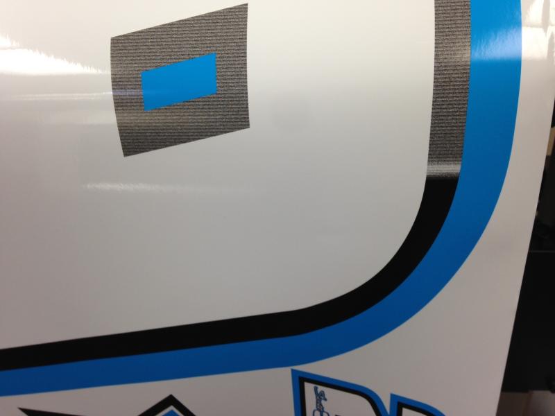

That was my first thought to. I just changed out to another new damper and the same problem continues. Here is a picture of what it does, starts off perfect then starts to fade out.

Pump?
Could it possibly be a pump? Or it could be getting air in the line. Either way it appears to be losing its "prime."
anozira02
try flushing out the print head, check the clear tubing on the capping station it may need cleaning, check waste lines free of any obstructions, change the damper at the black ink line..
