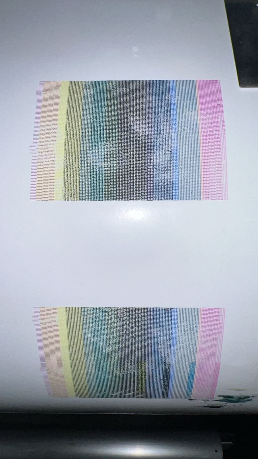

Hello,
can someone help me understand this problem on my VS60? Do I need to replace the main board?
The machine was stopped for a long time and we replaced the printhead.
S2DZ
The technician says that:
"The microprocessor on the board which is the key element is not good."
But I'm not very convinced with that answer.
