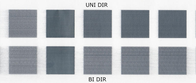

First, some square patches printed in metallic silver (with various percentages like 100%, 70% etc)

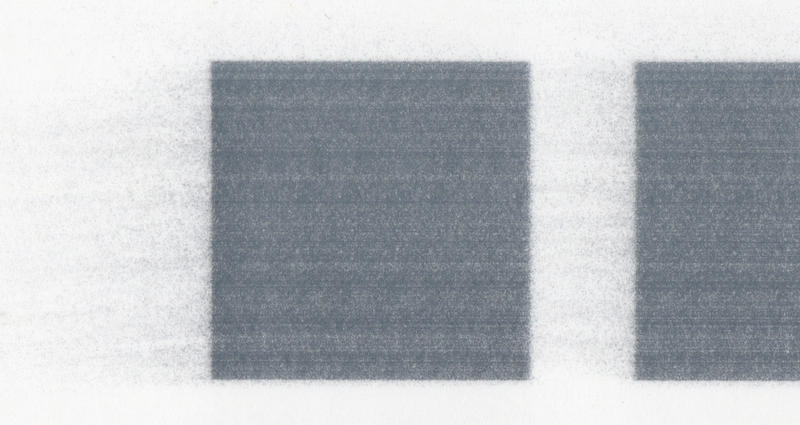

Here is a close look at one patch at the left edge

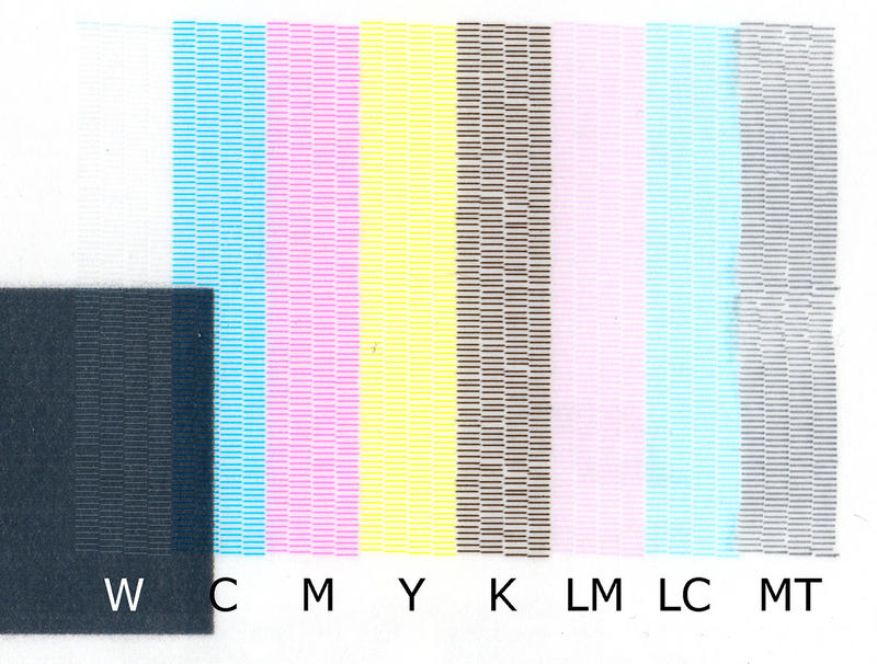

A test print (The square on the left is not of the test print :)

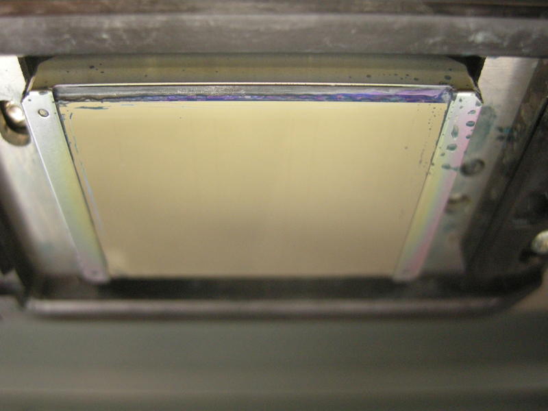

At the end, a close look of the captop - there is a white or maybe metallic spray on the right
in the area I have marked - Don't know if this is normal - just a note about this.

all the nozzles are firing, thats good, mostly the black and metallic aren't firing straight. Black, white and metallic tend to start deflecting sooner than other colours due to the ink density. Because all the nozzles are firing, the cap and dampers are probably ok. Something like a head soak and/or choke clean could loosen something thats causing deflection.

Thank you, as for the head it is shiny and clear with no damage. I will try a head soak with a new captop overnight and I will post the results. For the time now, I left a new cleaning flud cartrige in the place of metallic to slowly clean the metallic channel. Perfect print is important to me because I print dedicated works like small stickers with very small text. White (most often) and metallic are used not very often, but I use them.
