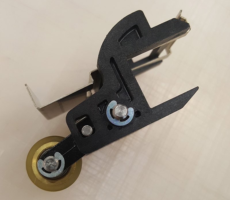

Get a flash light and examine the roller cages where they clamp on the torsion bar. We had the same issue. There was a small crack
in the cage which would cause it to track inconsistently due to uneven pressure from side to side.
Do you mean the permanently mounted ones, or the ones that can slide in and out? And where on it was the crack that you found? We looked them over and haven't found any cracks yet.
