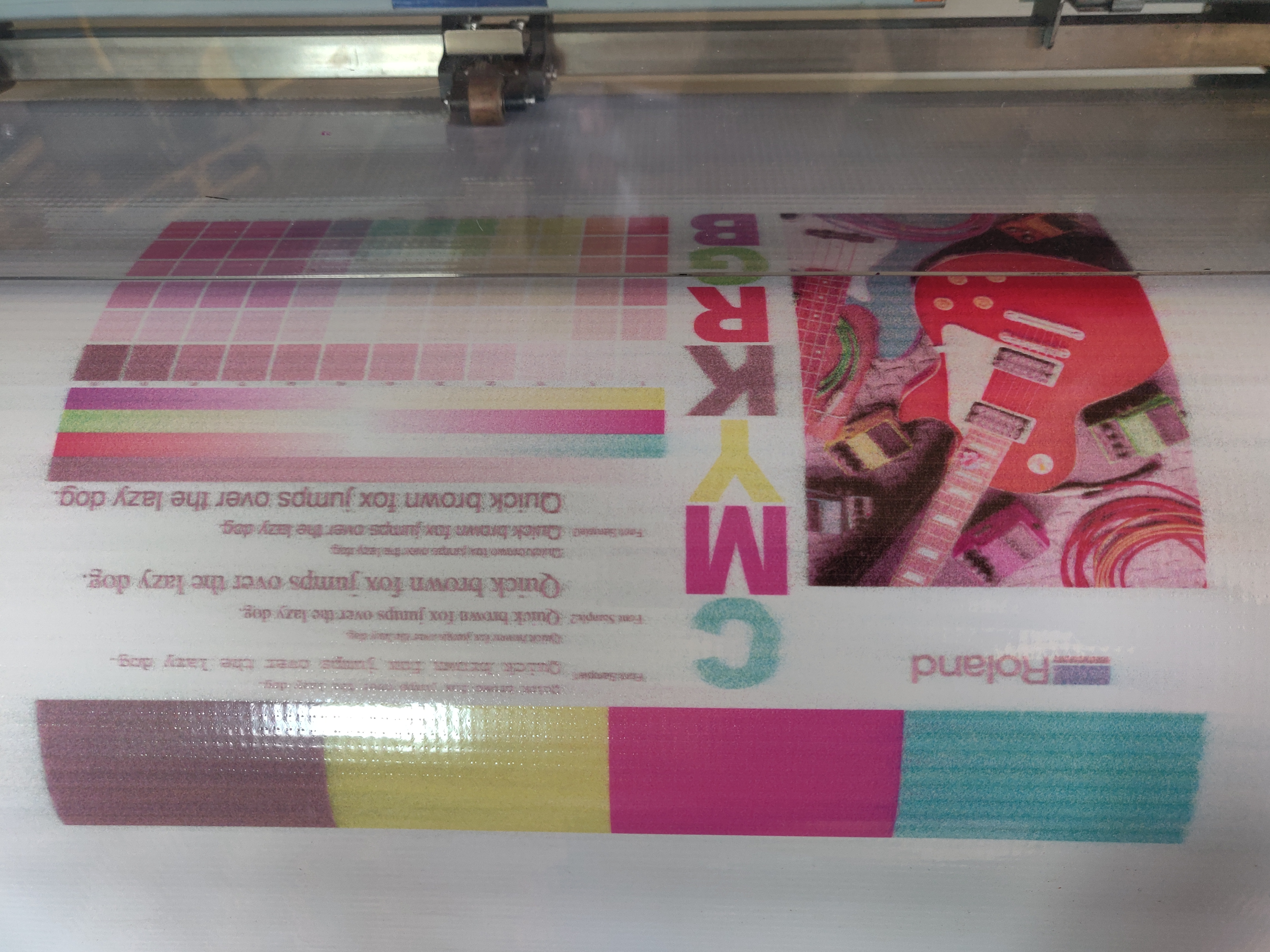

Hey guys, i recently bought a used VS540i from a shop that closed down near me. Now before the shop closed down, i went and looked at the print quality and everything seemed to be good and image quality was good. Now a few months later, i think they may have had the printer sitting for a while and i received the machine now and its printing terrible. when i first got it it literally wouldnt print anything and then i did quite a few cleanings and now its printing like this. What do you guys think the problem is? dried up heads or does it look like something else? i did many cleanings and also a manual cleaning. Thanks for all your help

Yeah they go bad if they sit a month plus. After a month they can still be recovered but your chances go down hill each day it sits unplugged.
From the head pattern missing nozzles in even blotches like this across multiple colors really looks like it’s had some severe head crashes into the print media. Get the head to the left of the machine and take a look at the surface of the print head. If you see shiny streaks, scratches or anything else odd that appears as damage this can help in determining the head condition.
The other issue is the type of overspray you have. Usually from my experience that overspray means the head is cashed out.
I would be extremely surprised if you had a tech come in who could get that head into even %90 firing correctly.
If you change the head make sure you change the dampers too especially if the machine was sitting and or running aftermarket ink.

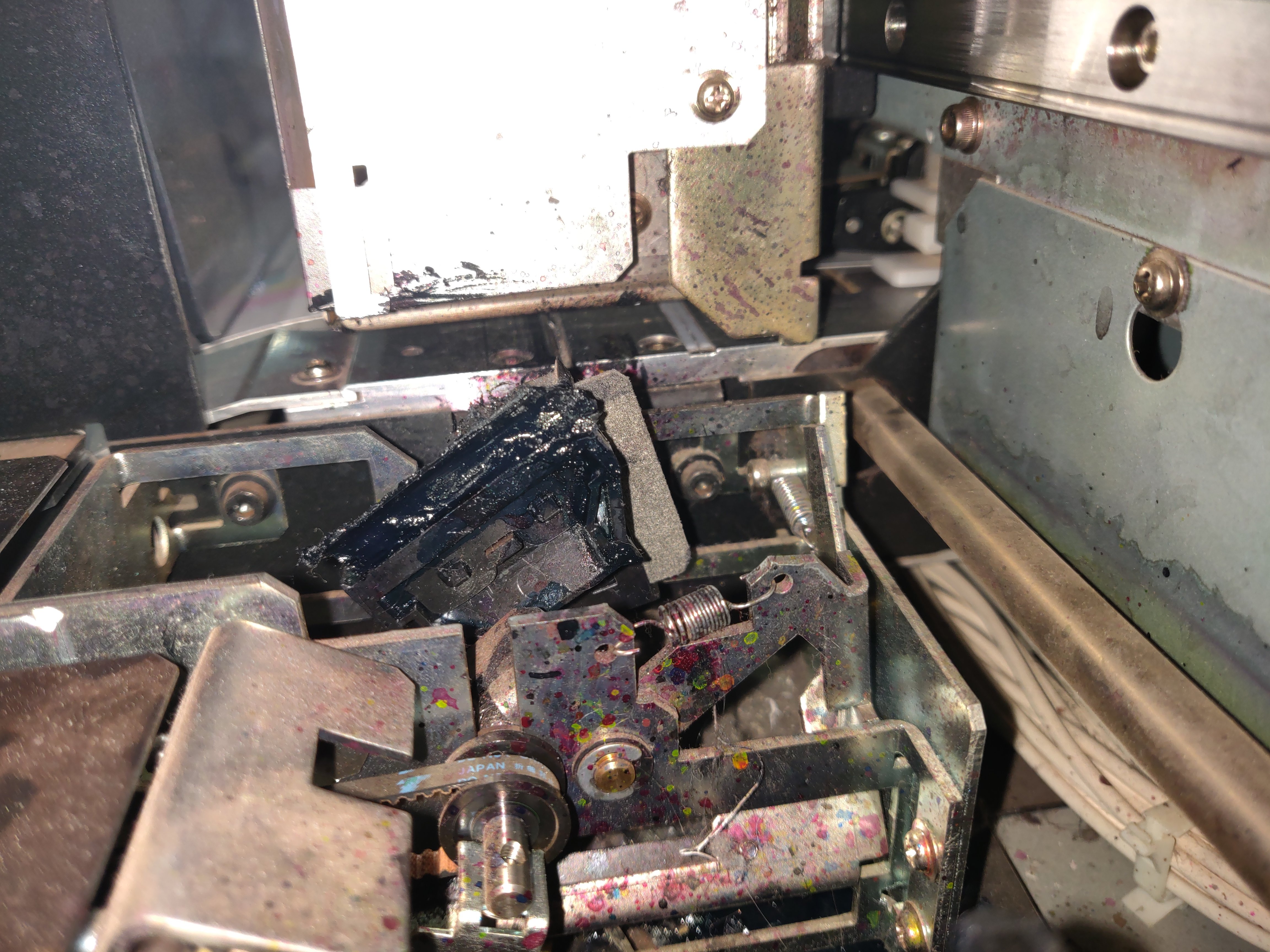

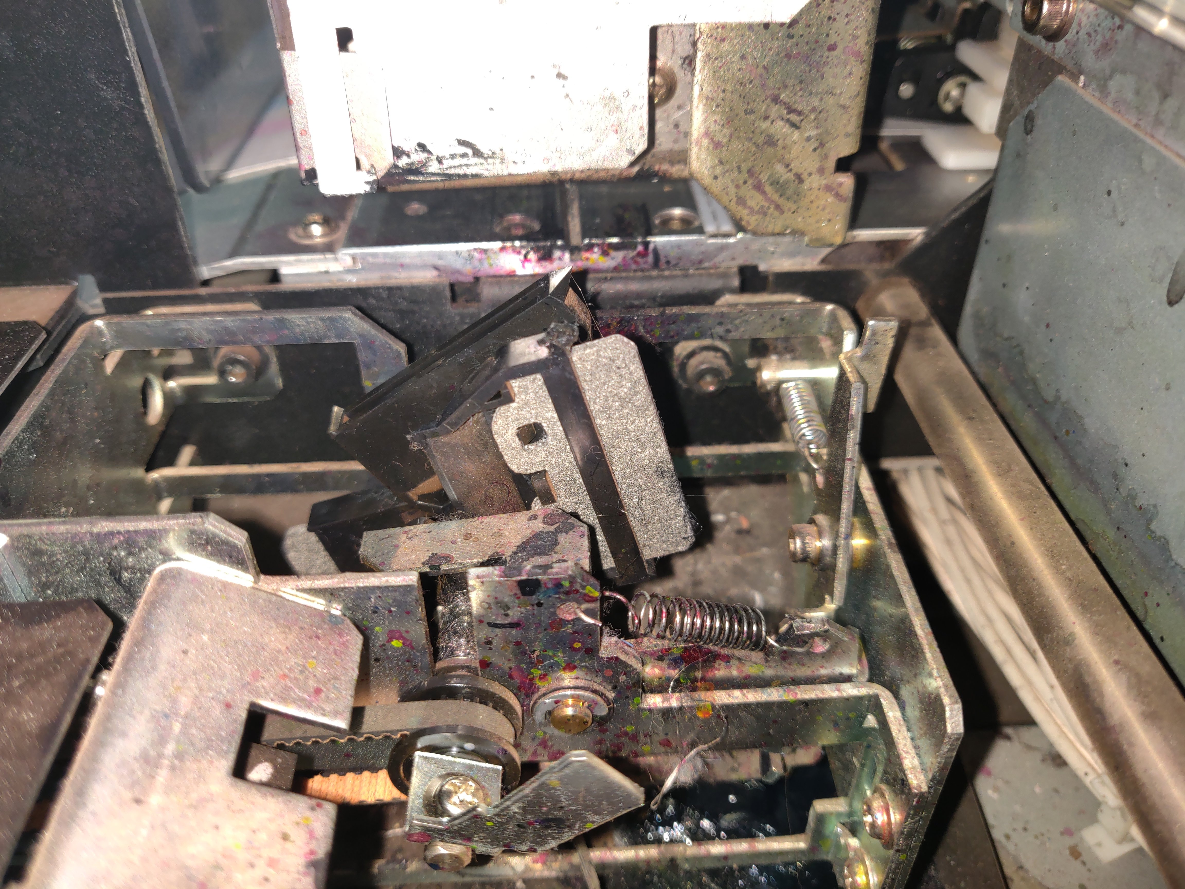

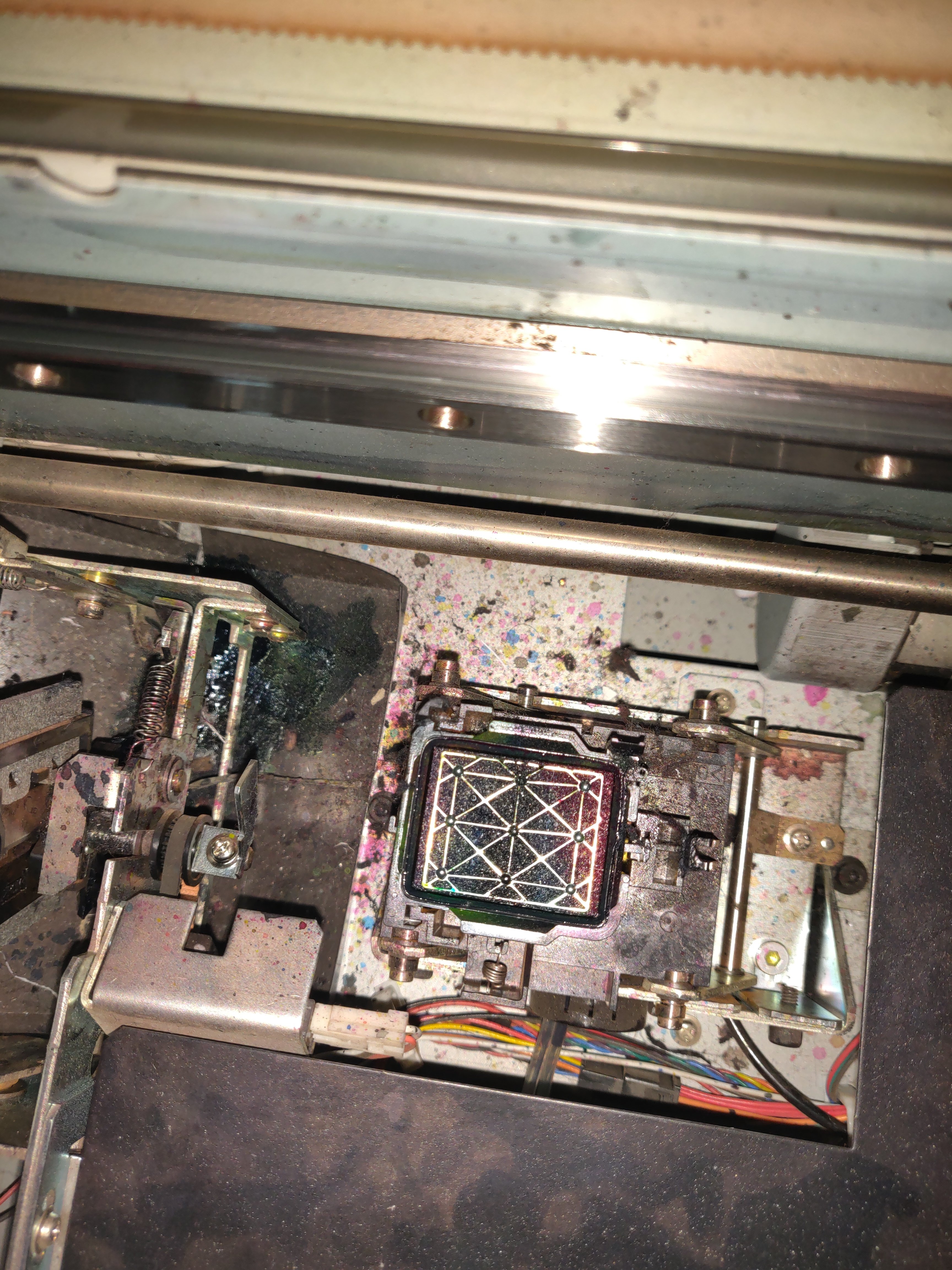

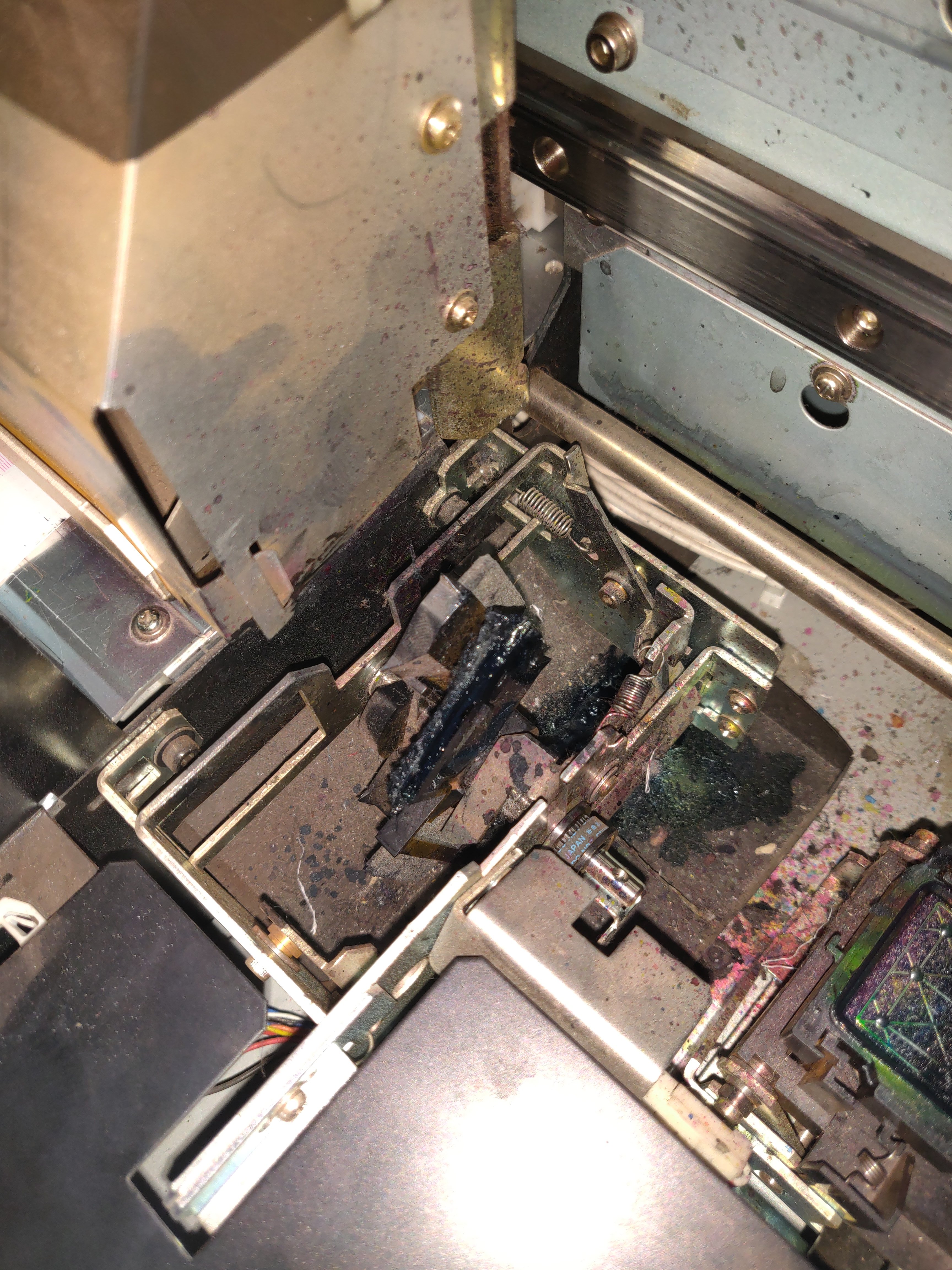

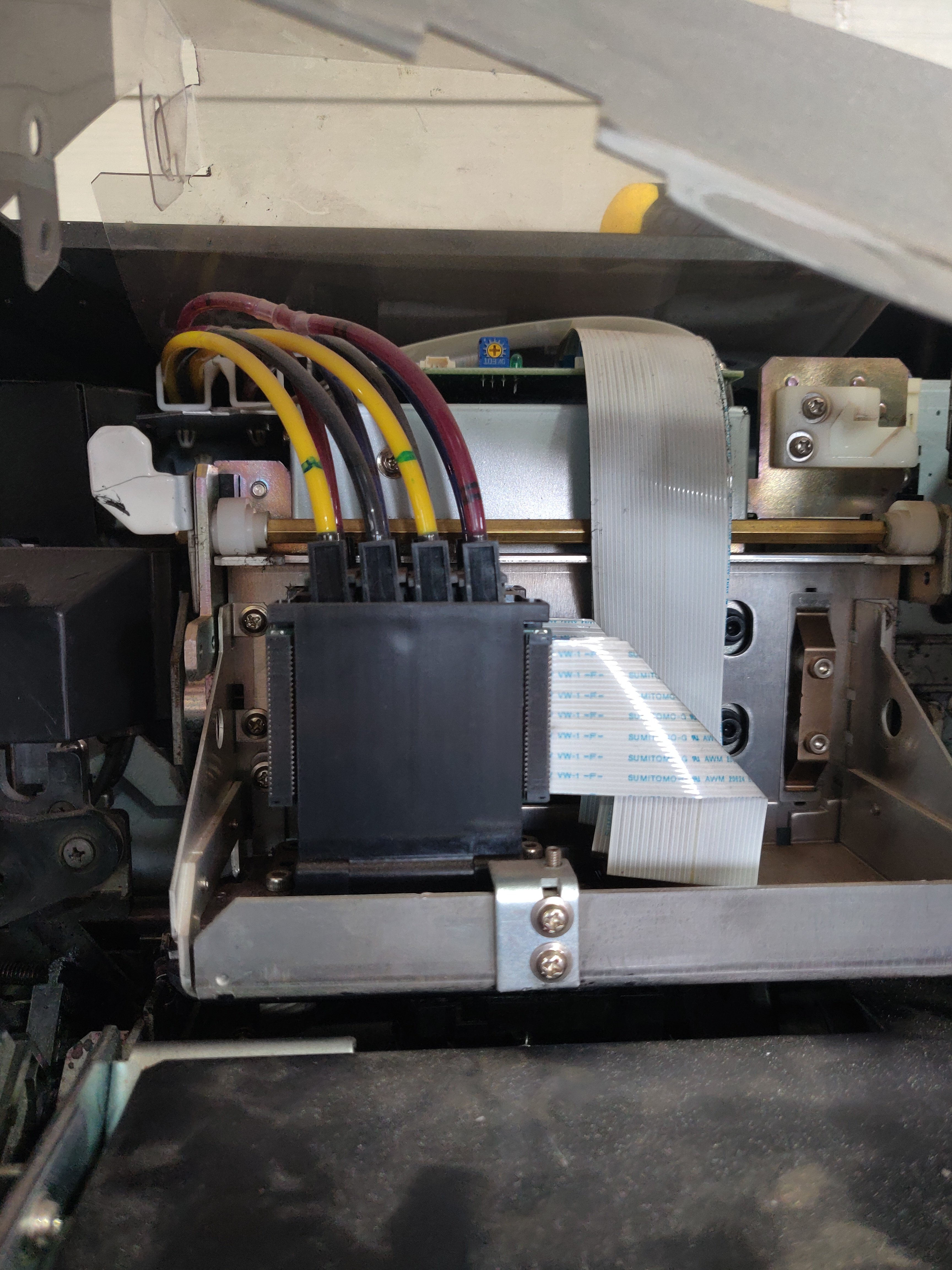

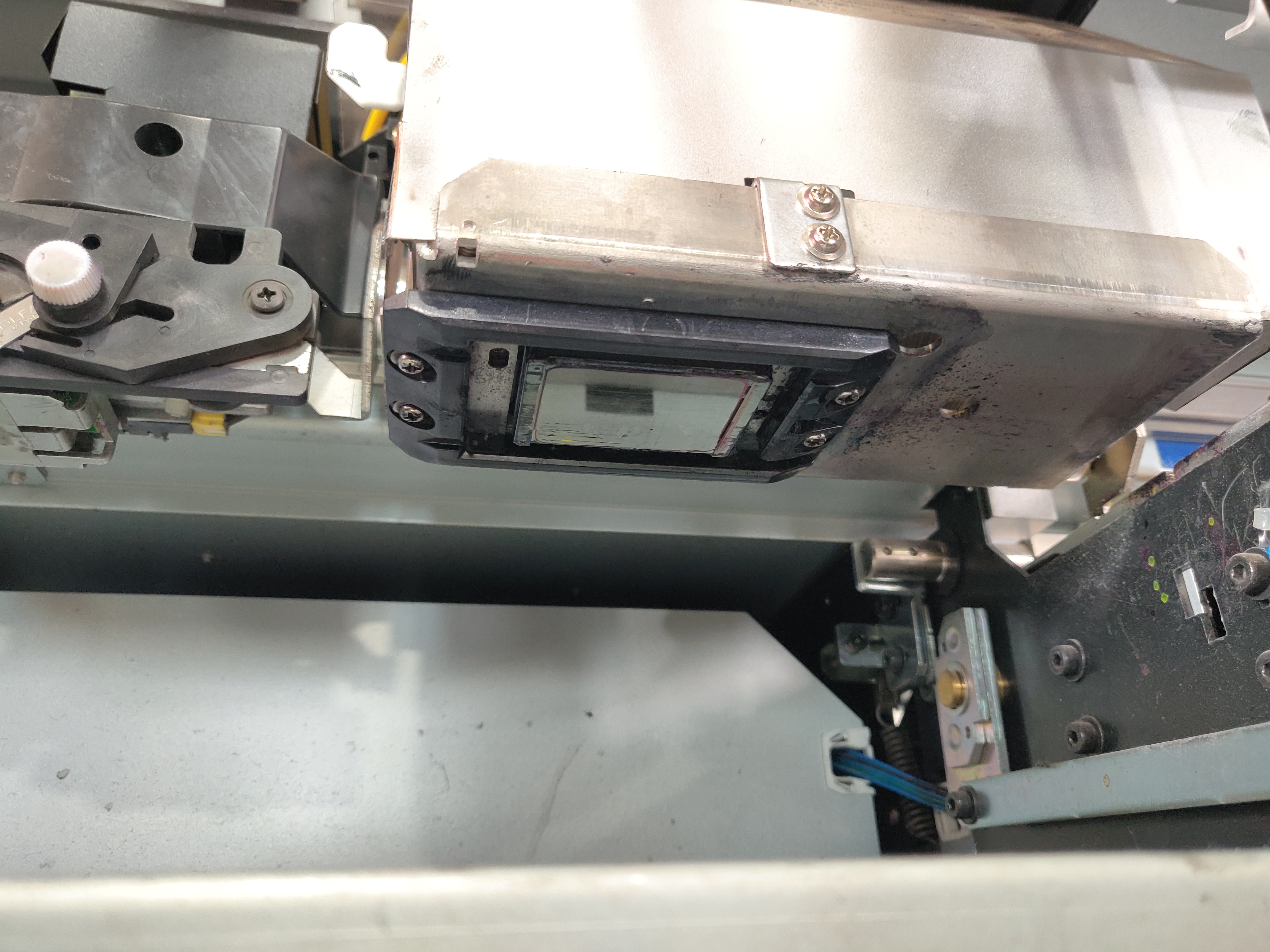

I just took some pictures of the right side and it looks nasty. looks as if the guy never cleaned the printer since day 1. I'd like to order everything i need to for it. can you verify if these are the right parts and the right amount?
http://www.extremeinkjet.com/Versacamm_Tune_Up_Kit_p/tuneup_vs.htm?CartID=1 I need one of this, right? it looked to me as if the printer took two wiper sets? two felt ones and two rubber ones.

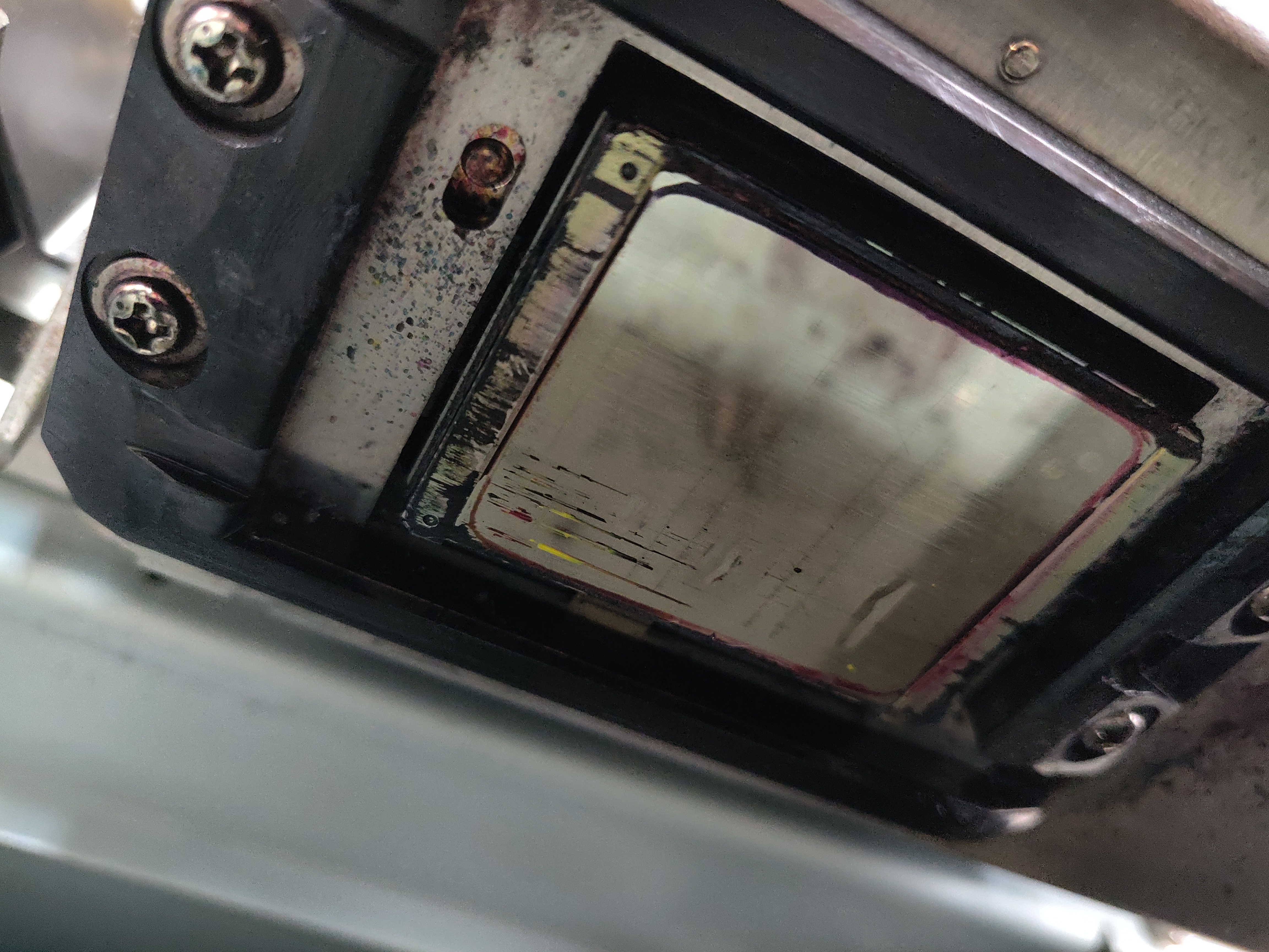

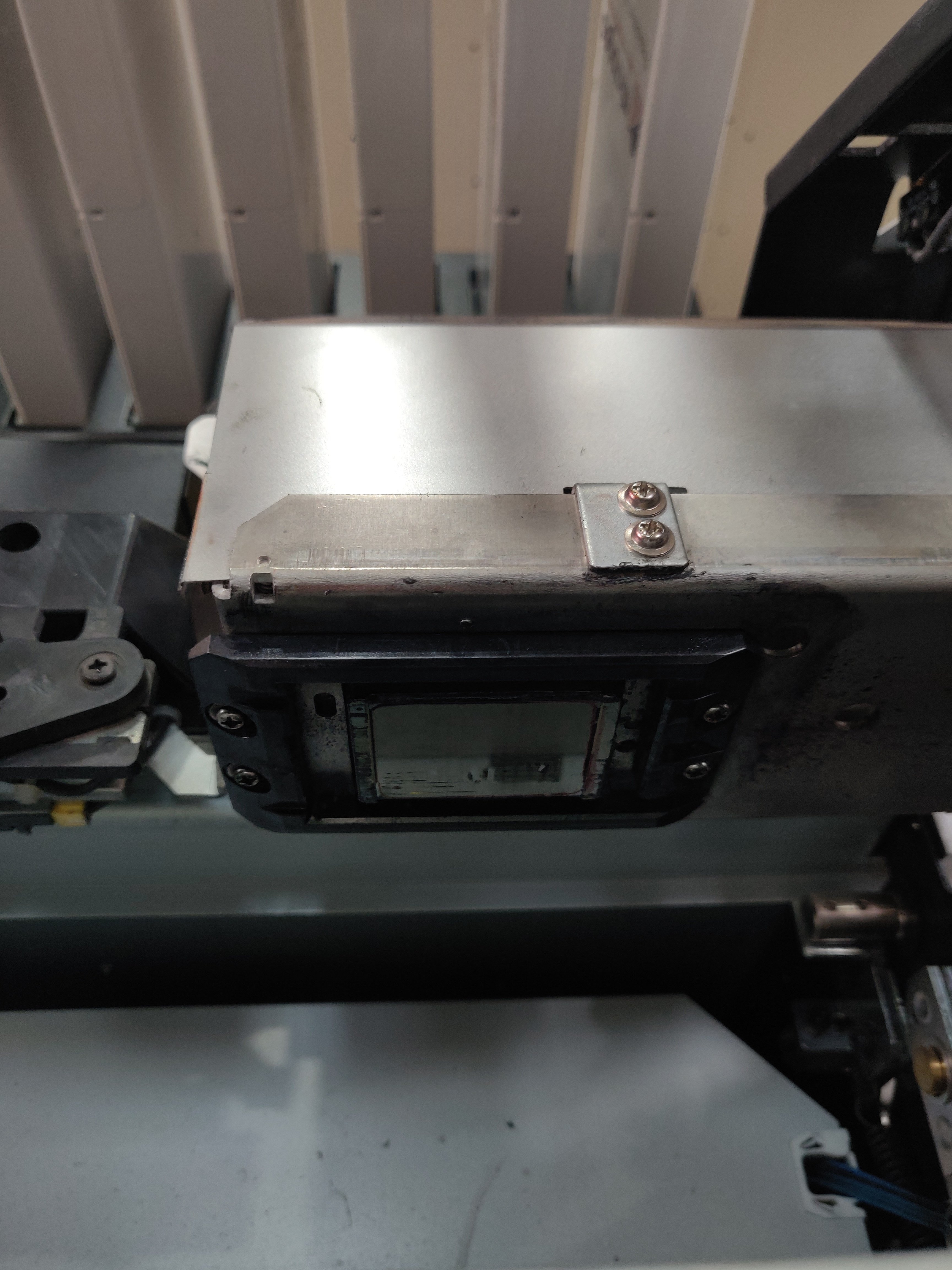

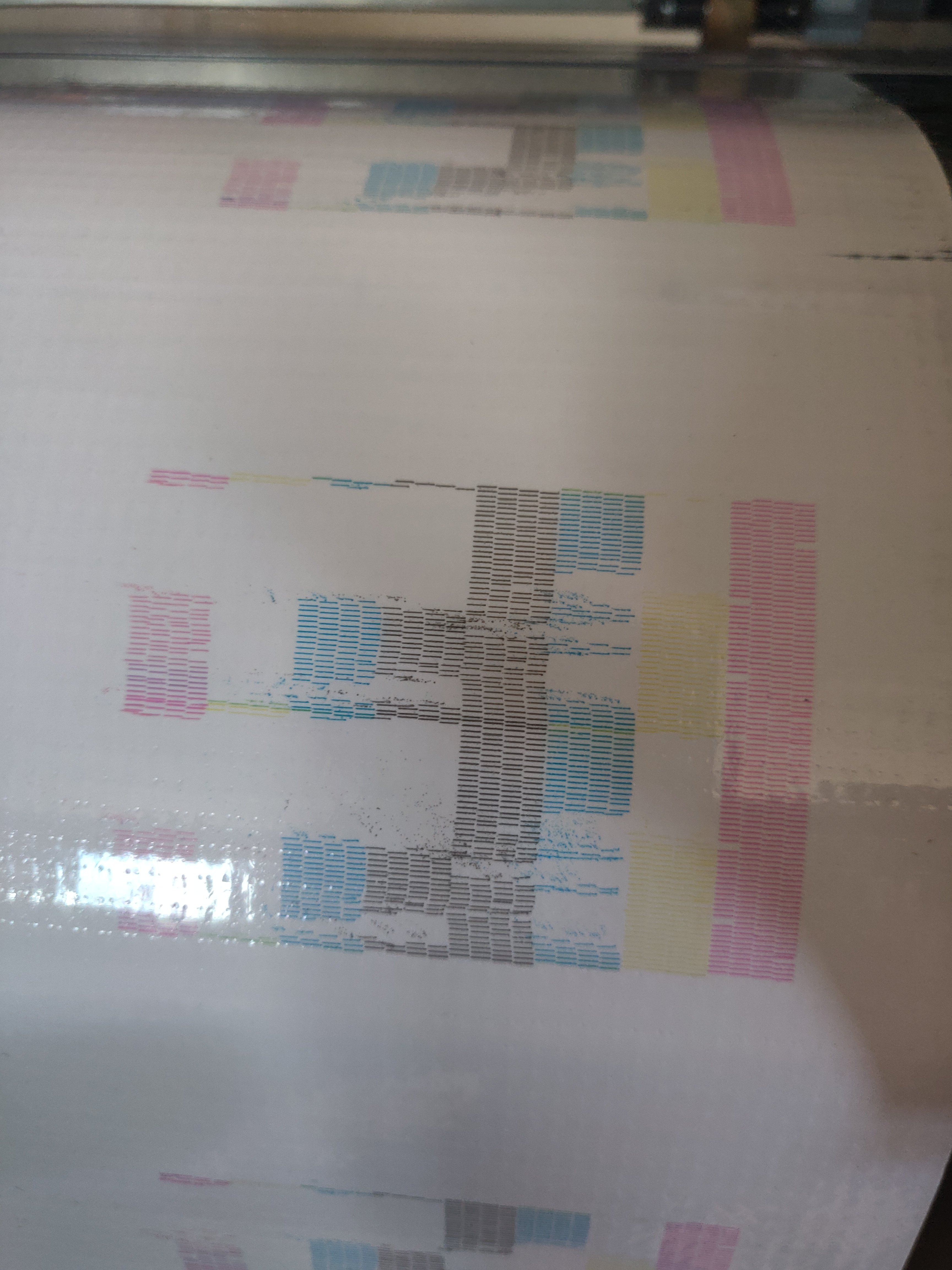

Do i need anything else besides that? Also, take a look at the pics of the head, thats after a manual cleaning and then a power cleaning.

It only looks like a wiper is missing. Don't worry about it. The one you have is trash though. Your felt looks good, but it's in the wrong position. Your print head is a lost cause though. You'll need a new one and as indicated before, a set of dampers to go with it. Since you're not familiar with the printer, I would recommend that you find a tech to come do the work and observe if you can. Also have the tech show you proper maintenance. You probably also need a wiper scraper as well.
And, if you ever need to leave it sit, make sure that it's plugged in with the power on. And do the maintenance once a week whether you use it or not.
Good Luck. Wish I could come to Belize to do the service for you.

From the looks of your pics no one replaced that print head recently.

We are Jetbest master distributor in the US. We can help you. You want to buy original damper and original cap top for your VS540i. Aftermarket parts will not work well on this type of printer especially the DX7 printhead powered printer.
We recommend
Original damper from Epson. $85.
Original cap top from Roland. $119.
I would buy four dampers, one cap top and wiper as a cleaning kit. Install them on the printer. Now use cleaning cartridges to perform head wash. I would leave the cleaning solution in the machine for one extra day. Do one more head wash. Now install Jetbest ink to the printer. If the head still need replacement. Now replace the printhead. That is what we do to replace printhead for our local southern California customers.
