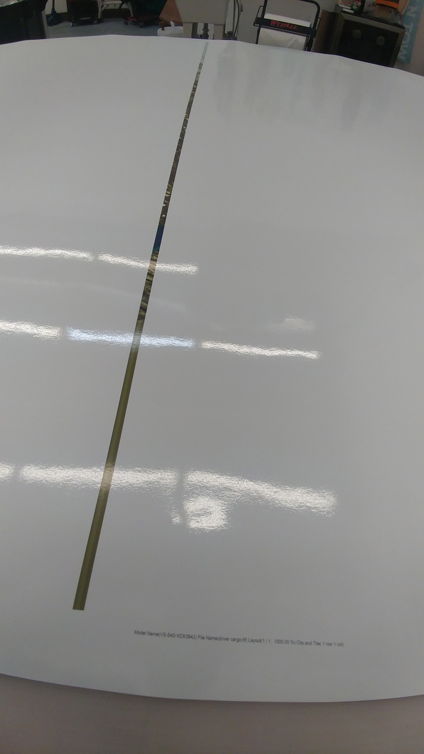

It was printing all fine then it printed a few rectangles with sharp edges but totally wrong color and size. Looked like it took a couple of inches from the file and only printed that. Let's say I was printing a full side of a van which would have been 50x210 inches but only printed a 50inch x 1-inch piece that was TOTALLY wrong color but the edges were sharp. like it finished the print.

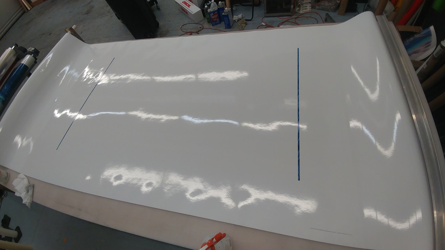

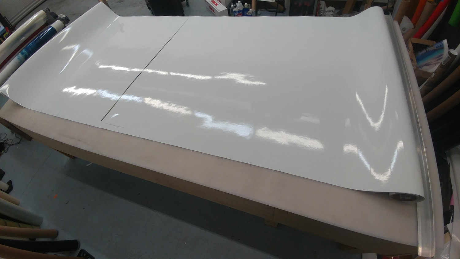

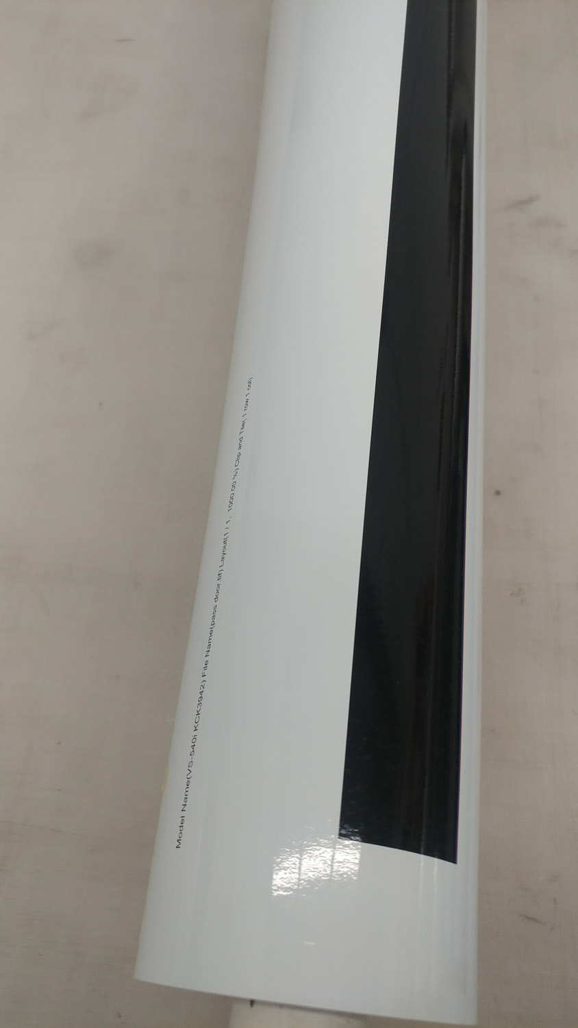

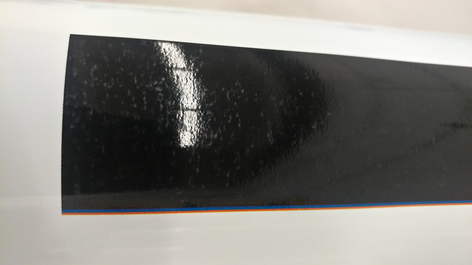

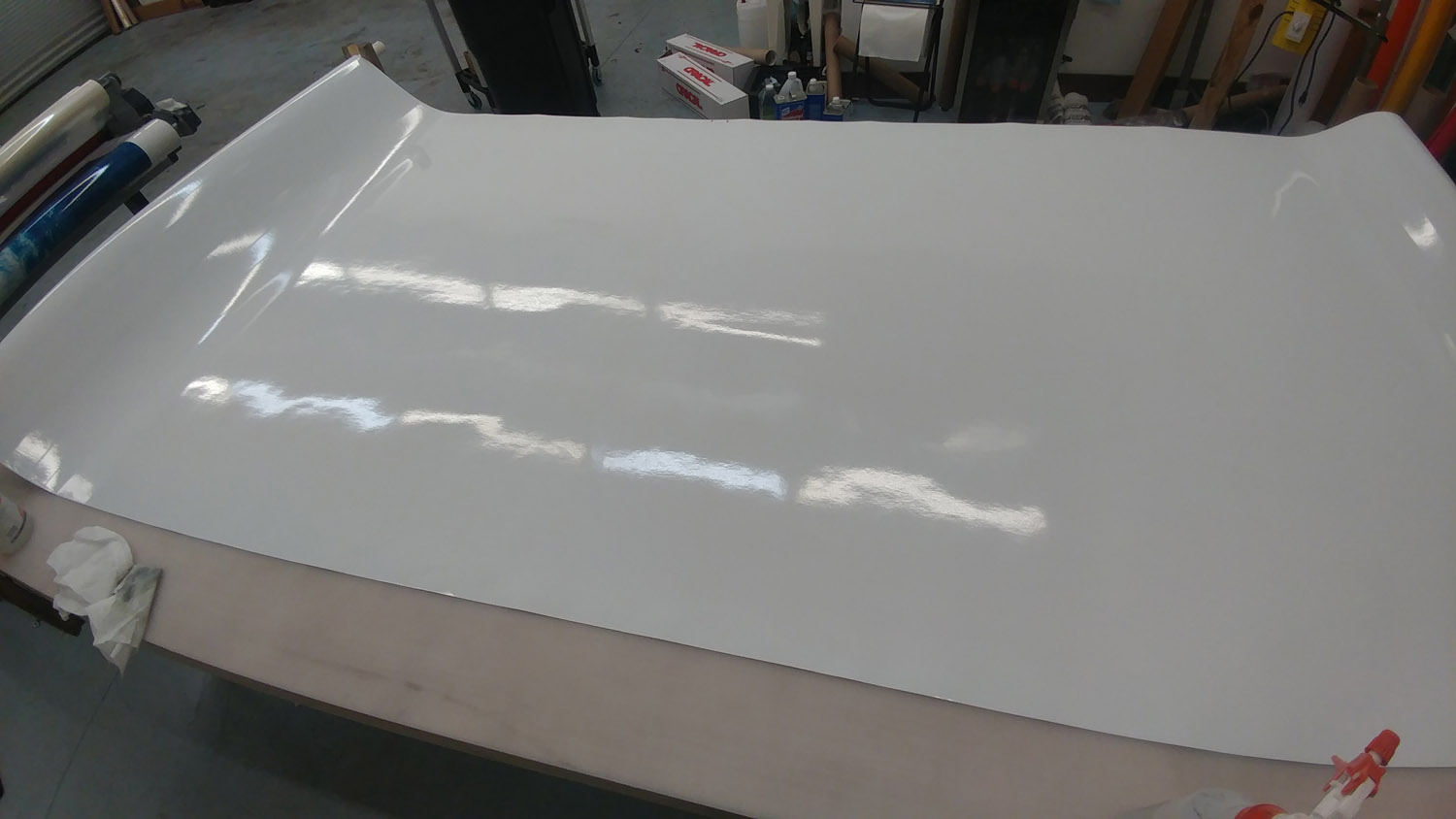

Fast forward to now. I was printing another van. Totally different files. Even photoshop if different ( just upgraded a few months ago) the files are tiff like how I always save them. The difference now is that it printed only half an inch and then the printer rolled off hundreds of inches of the vinyl without any print. Then it stopped and printed another half an inch of another graphics for the other side of the van and emptiness for hundreds of inches. ( see pictures). Also printed the back file which one was 2 smaller prints.
It even printed the job properties but the graphics only printed half an inch and it has sharp edges all around ( no fade off) and totally wrong color. Should have printed ocean blue and it was green/brown.|
Also printed 1 weird black line with a thin line of RGB next to it.

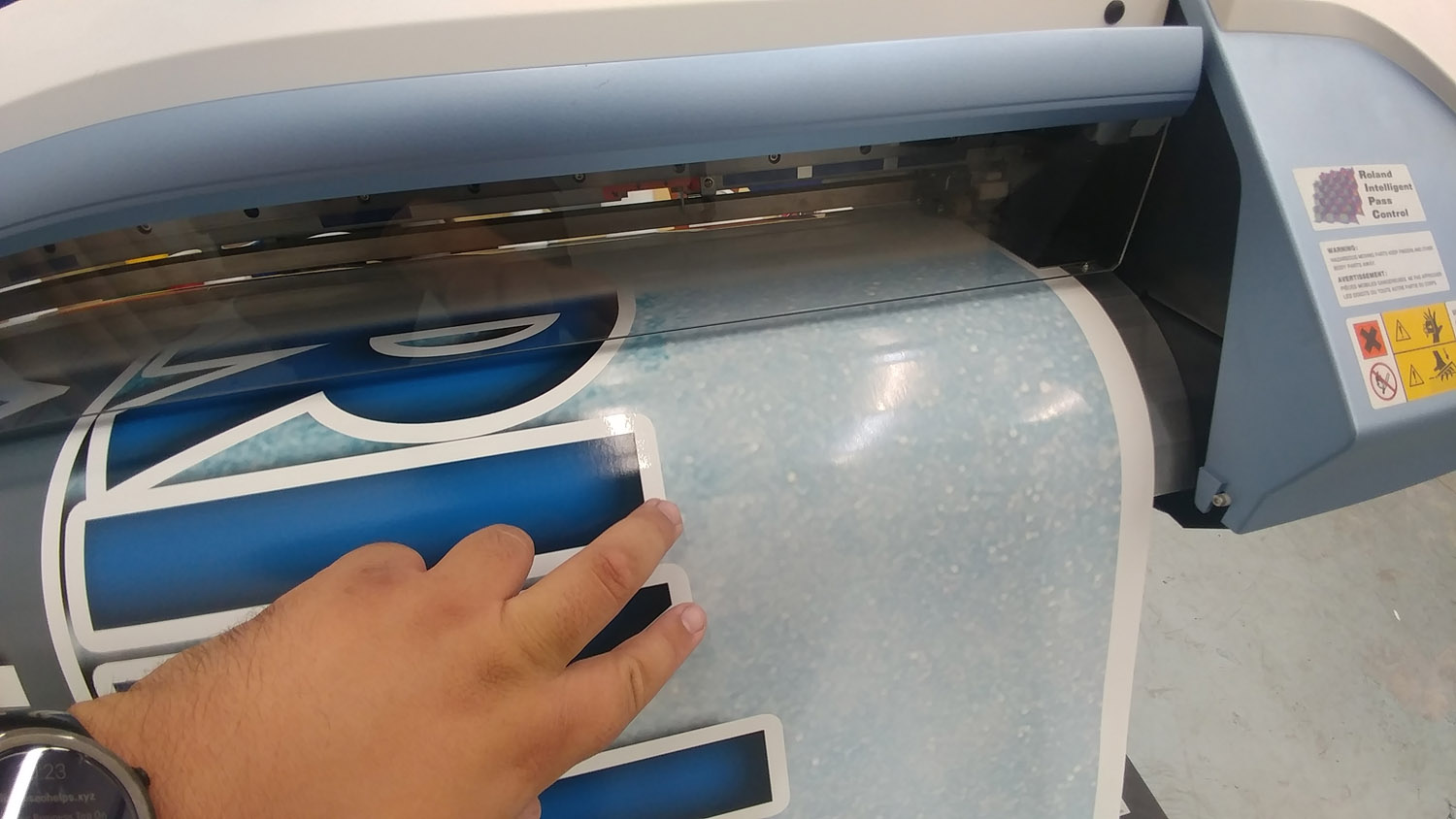

I did not want all the material to go to waste so I slipped on some rubber gloves and washed off those freaking stripes and loaded the vinyl back in to the machine and just finished reprinting the two sides.
if anyone wants to know the best method i came up with was: rub the ink off with alcohol. No circular motions. No need to smear it around. Alcohol left a faded color so then I did the wax on / wax off method.
In one hand i had a rag with some xylene ( very light mist). In the other, i had another rag with lots of alcohol. Light xylene rub then immediately clean it off with alcohol. Do not let the xylene soak in!

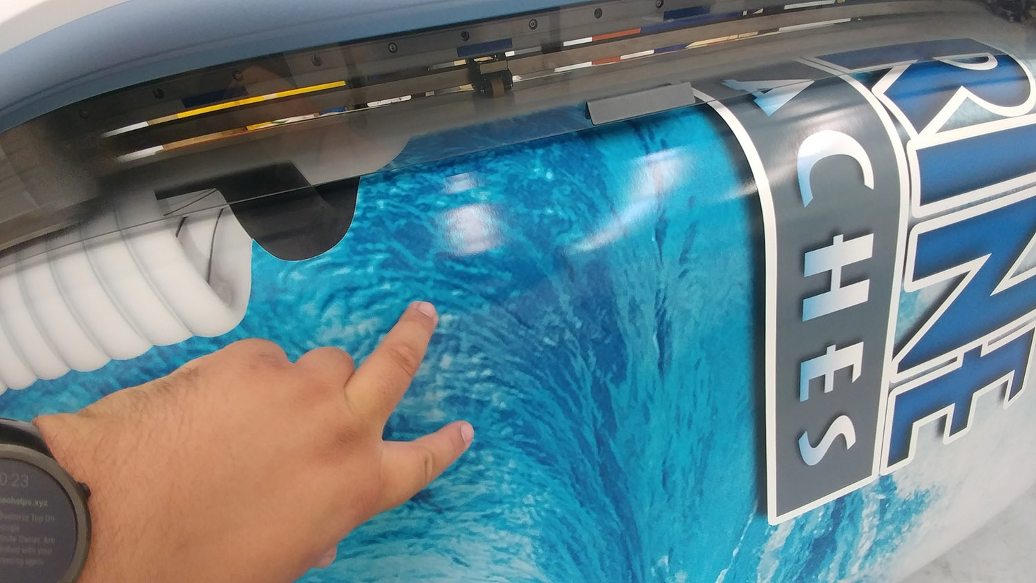

i was afraid the ink won't lay as good but fortunately, it turned out pretty decent! If your graphics is busy enogh you will not see it. Iif you print solid color you will have a problem for sure. I really had to look for it but eventually I did find the area that was cleaned and I am trying to show it with my fingers (between them) where the "discoloration" occurs because of the chemicals. (see pics)
