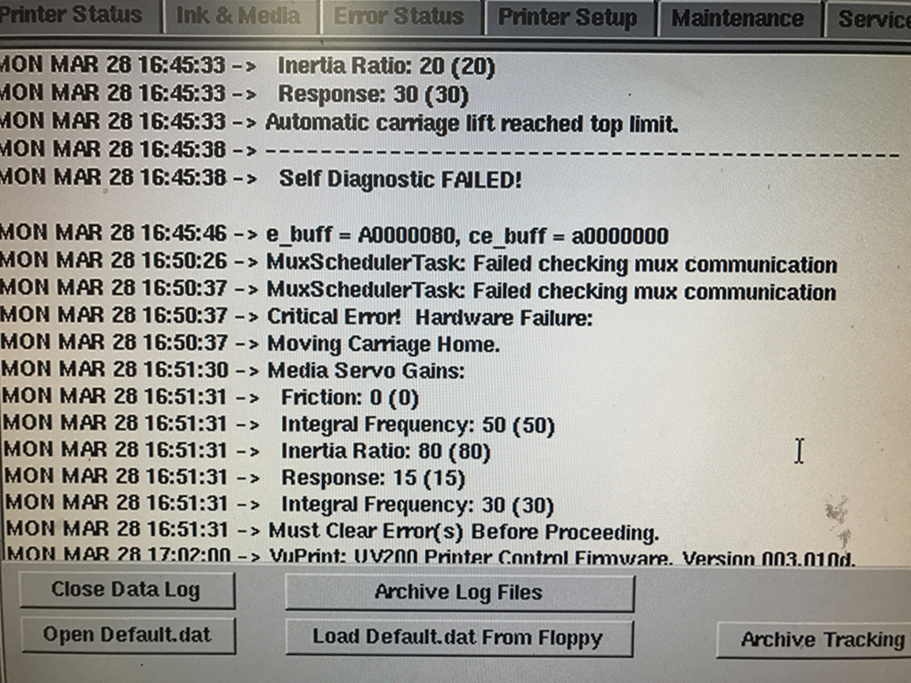

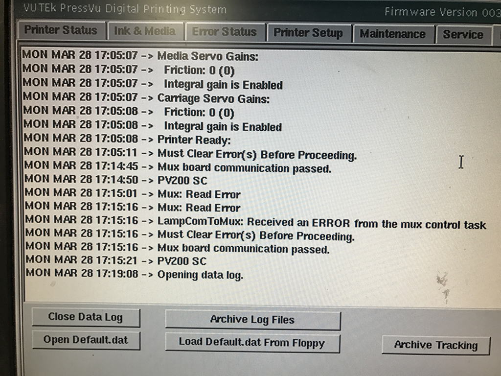

Hey guys, our company just picked up a Vutek PressVU 200/600 (second hand). We managed to get it "setup" this morning and have been fighting a few errors.
I'm completely new to the flatbed market and zero knowledge on how to diagnose these things.
We're catching an error from the lamps. I'll add some photo's below. Any help on how to or where to start to get this thing working would be greatly appreciated.
Mux: Read Error
LampComToMux
ImagePress
It looks like something is wrong with your MUX board (the communication board that's on the back wall in the ink cabinet). I can't remember if this is the one with a daughter board attached to it or if it is a single board. Either way, I would suggest making sure all your connections are tight first off. If all the connections are secure, I would lean toward the MUX board needing to be replaced.
