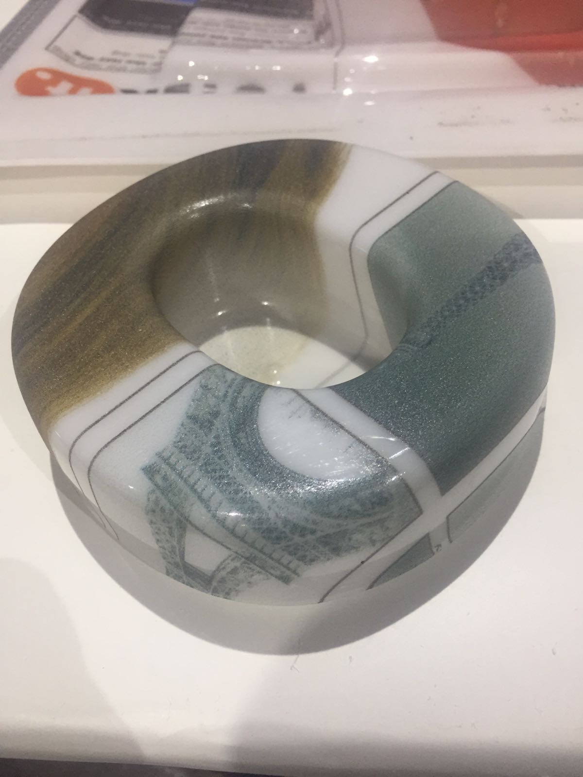

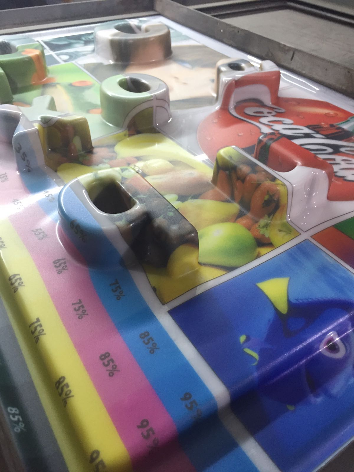

search this ?.......use MGF Ink from INX/Triangle
Datasheet find on INX/Triangle for MGF inks...have fun
