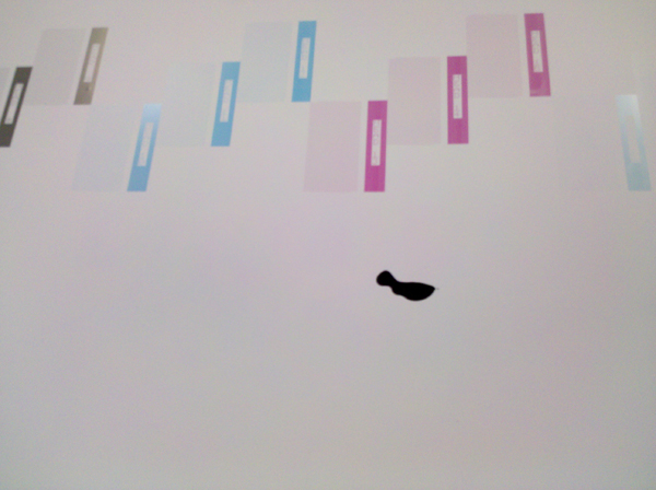

Ok animenick65 I got one for you. Whenever I do an ink purge and jet test I will get a huge glob of black ink on the substrate. I'm posting a pic for reference. Your thoughts?

animenick65
Is it only during a jet test?
About how fast is the carriage coming down when it's setting height? It should be relatively slow. This is for several reasons. A) If it came down too fast you could de-prime your jets. B) You don't want it coming down too fast on soft substrates as it will make an indent and/or cause your head height to be inconsistent. and C) There is a lot of crap on that carriage and you don't want it being jolted around like that.
I would first uncap the carriage over the capping station and inspect each jet to see if it's wet. Right after a purge it should be relatively clean. If you notice that after a purge one or more of the jets in a color slowly becomes wet then you could have a malfunctioning venturi, incorrect manometer pressure or a leak somewhere. Are you wiping the bottom of the carriage/jets as recommended daily?
Also, try cleaning the underneath of your carriage and then doing a purge, then re-inspect the bottom of the carriage. If you notice lots of ink buildup on the surrounding plate, then it could be splashing from the purge tray. When the purge tray is moving in and out is it relatively smooth? Is there any ink build up on the purge tray rails? Are they oiled?
Aqua5
The carriage does move very slowly up and down when doing the jet test. It only happens when you purge ink and then do a jet test. I clean the machine daily per the instructions given to me by the tech who was here. I've even cleaned any buildup in the tray to eliminate that as a problem. There is always some formation of ink in the tray however. I would tend to suspect there is a leak of some kind. It only makes sense because of the issue and amount of ink I see in the tray and residue on the head when I clean it. I will keep you posted once we have it checked.
