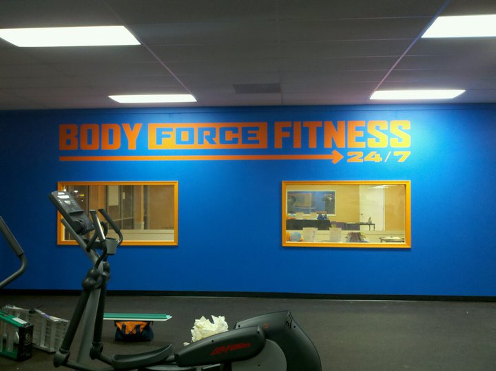

Bam! Took me and my father 2 hours to install. No seams
You can see my 32" BS there which we used to lay it down then used a hand squeegee to finalize adhesion
