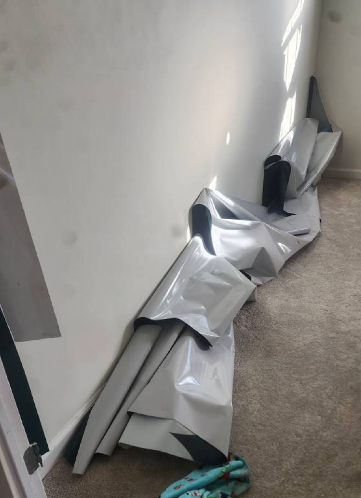

Just got this in as I was replying to this thread, risk you take using the removable materials. This wall looks kinda dirty, maybe closeup pictures will reveal a fine sand texture or maybe this paint has a chalky feel. (I did not do install)
Got some info back from the customer and in this case Stain/scrub resistant paint is the issue. Sherwin Williams showcase. Customer did not follow instructions that recommend additional adhesive when using this type of paint
