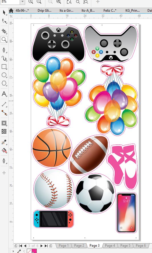

We're a CorelDRAW based shop, and print to 4x8 coro sheets. Lately we've been swamped with yard letter and flairs. We have a TON of new products on our site, all of which were built and prepped in Corel. Here's how we do it now:
1. Order comes thru our Woocommerce site, I grab a screenshot of the listed items, paste into CD to refer back to.
2. Then I go thru file explorer to find the various letters and flairs. Thankfully, we gave them descriptive filenames. But it's a non-stop search in the explorer box. open file, copy/paste to the order's layout sheet.
3. Copy/paste Optiscout reg dots and export to PDF.
Not too bad for 1 - 4 sheet jobs, but utter AGONY with the 10 - 20 sheet orders we get.
In our haste to get everything up on the site, we skipped assigning SKUs.
These are all custom contour cut, so each sheet is a jigsaw/tetris puzzle to set up. There MUST be a better way to do this? How are other companies doing this? We're on CD2020 if that makes any difference...
tedbragg
I've attached one of our less crazy ones. Everything has to be laid out a certain way, so the flutes are going the right direction. We use 96" long edge flute sheets, so that makes things even more tricky to put together. Each individual item has a 5 digit number grouped with it, so when all the pieces are on the sheets, a quick find/replace can update it with the order/invoice number.

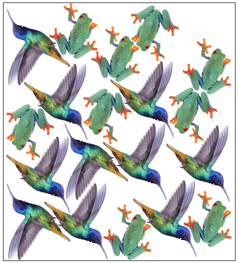

Looks like you are looking for true shape shape nesting software. There's alot out there like tilia griffin, caldera prime center, or print factory.
ikarasu
True shape nesting would mess up his flute direction.
I think he just needs to use whatever rip / software that came with his cutter to nest, while turning rotate off... Should be simple.enough, but not familiar with that cutter.
Also sounds like op is using web software to make print ready files. In which case setting up a hot folder to auto import files would.be ideal
You can choose flutes in Trufit. And in others you can most likely choose to only rotate 180° for example.

We true shape nest all day on coro. As balstestrat said, most of your nesting software can mind flute direction.
