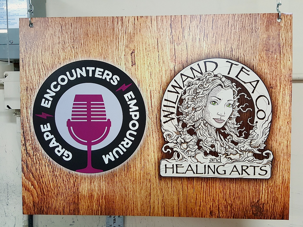

This thing kicks ass on coroplast, styrene, sintra, magnetic, acrylic, aluminum and usually on DiBond unless you're trying to accomplish really solid light grey or light colored backgrounds over a large area. It rocks on stuff with lots of built up blacks and boosted colors. If I'm designing something to be printed on it with a red in it, I throw a little pigment from all four colors into the color like giving it a multi-vitamin. ie: C: 5 / M: 100 / Y: 100 / K: 5 and you get a really solid build. On its highest setting 720 ppi / 8 pass Uni, it prints slow but the image quality is quite good.

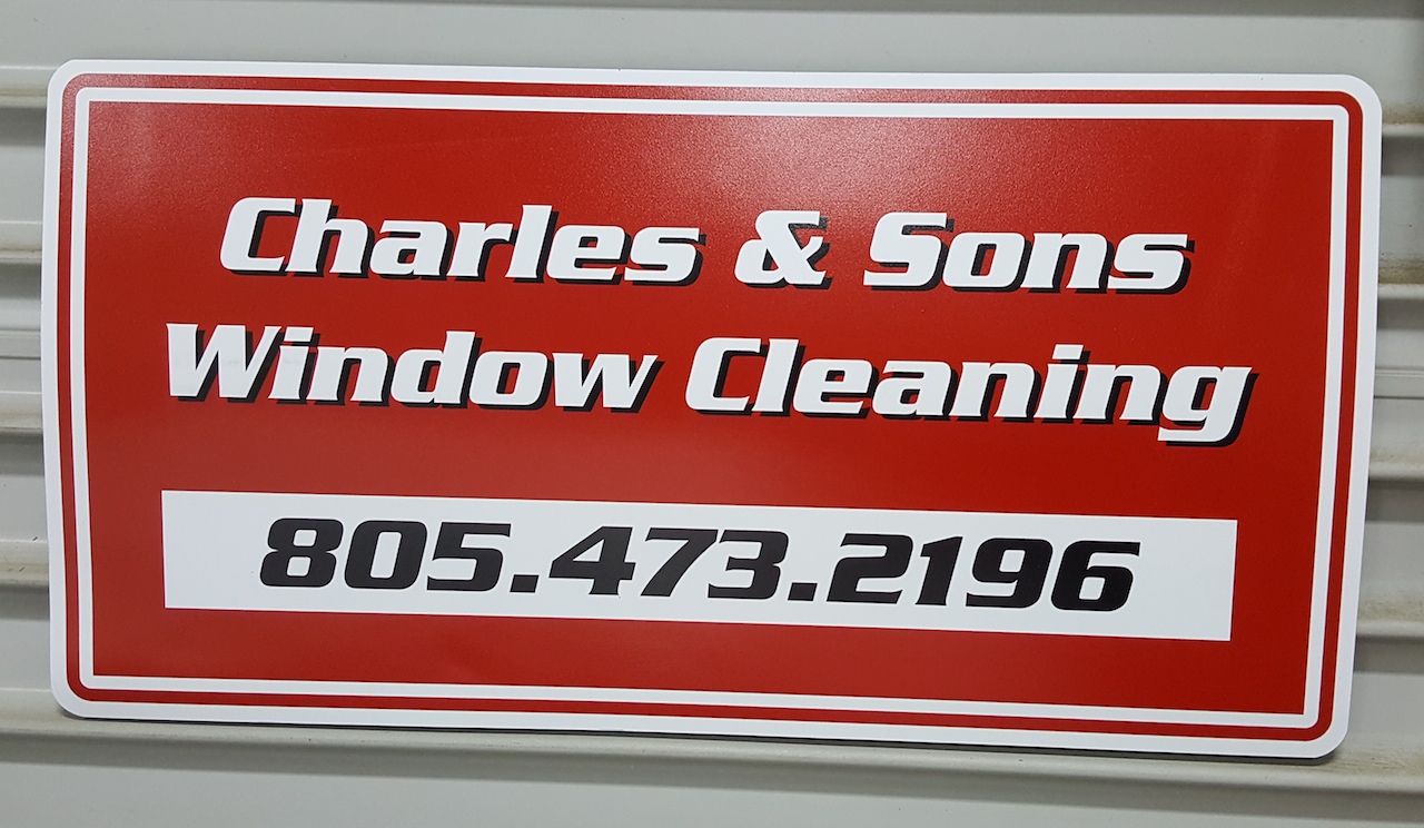

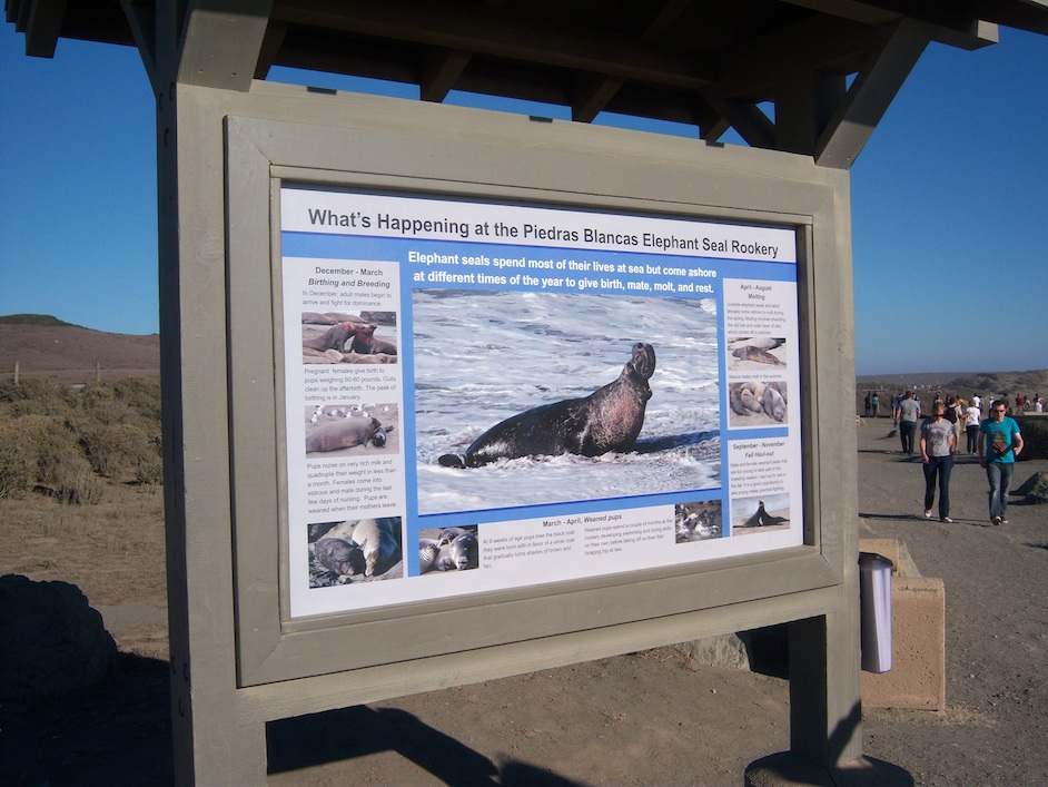

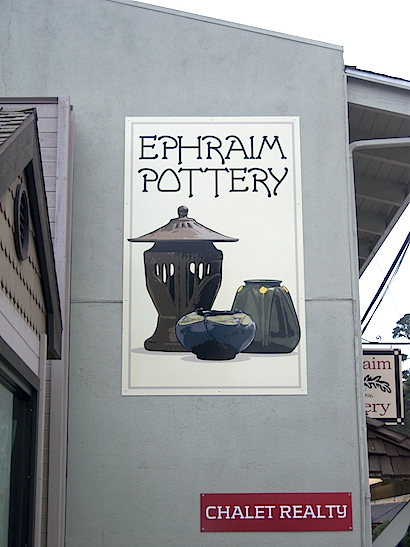

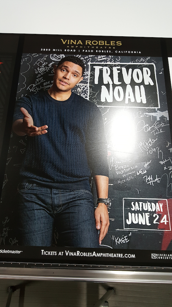

Here are a few typical jobs.

If I'm really worried about getting super solid background colors I'll either fortify the colors a little and run them at the highest setting, or like in the Charles & Sons magnetic, I'll dial back the fills transparency to 75% and run them twice at the 360 ppi / 8Pass Uni setting which goes twice as fast as the highest setting and it fills them in really nicely like you can see. The Grape Emporium and Trevor Noah are single runs on the highest setting. Every year we do dozens of the show posters like the Trevor Noah one for that venue along with tons of other work for them. It all starts with great artwork. We did one show poster this year for David Crosby with a really great image of him and it was super clean.
