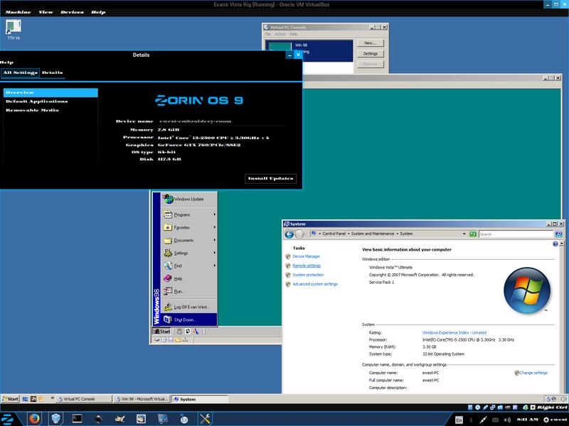

VM = Virtual Machine
It's essentially running one OS within another. For instance, I have Linux installed directly on the computer hardware, but I use VirtualBox to create a VM of Vista (I use Virtual PC within Vista to run Win 98 since Win 98 isn't officially supported by VirtualBox), Win 7 and Win 8.1.
So I'm able to run programs that run in those OSs all within a Linux rig. Now, I don't run more then one main VM at a time (the technical exception is the Vista VM that also run a VM of Win 98, ironically Win 98 still runs like native because it's supported doing it that way versus running Win 98 directly in it's own VM through VirtualBox).
