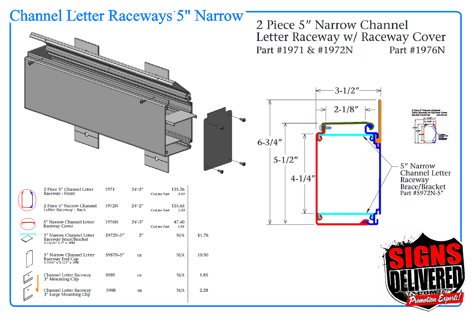

We have been using Sign Comp for our aluminum extruded raceways (1791 5" deep) and have been very satisfied with their quality, but we are needing a narrower raceway, and would like it taller as well... anyone know of other west coast raceway manufactuers? Preferrably a west coast manufactuer for obvious reasons, any thoughts would be appreciated - Thanks!

Nothing extruded, talking to suppliers, it would be to fragile, large, and expensive to manufacturer, transport, and honestly service.
As long as you are installing power supplies behind the wall, you can get away with framed .090" aluminum, use it as your wireway, then pull all your wires to the ps behind the wall. Or mount a .125" aluminum or ACM panel to your raceway, but then you have a hard time using the mounting clips.
My favorite is a sub frame and outside face frame, install the subframe on the wall, fit the wallsign over it, use some fancy connectors or ingenuity to make your power connection.
