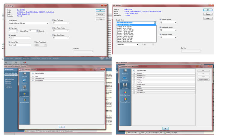

I have Onyx 10.1 and a Mutoh 1614 printer (Oce CS9160). I'm currently printing on Orajet 3551G media with the correct profile in Onyx (got it from Oracal webpages), but I feel as if the colors are coming out slightly bland, or washed out if you will.
It's not bad, but they don't pop as much as they should. Here are some screengrabs of a few of the media profile/settings.
Does anyone know a good way to adjust it in some way?

Best way is to create a new profile, otherwise you'll just be chasing after whatever your current tweak changed, and waisting time, material and ink.
