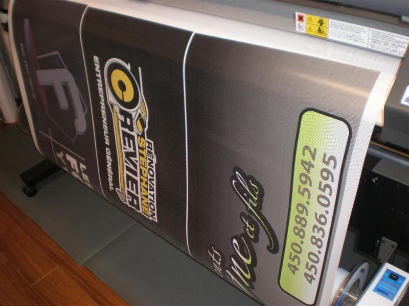

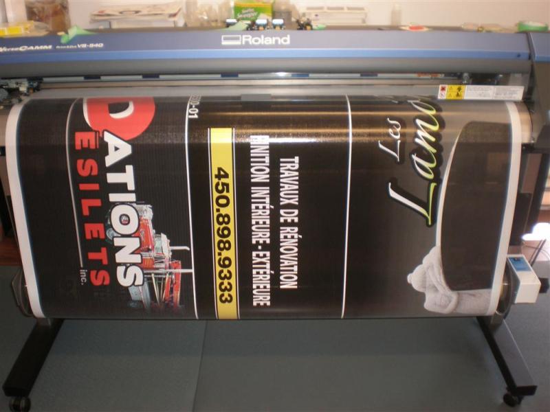

Weird banding... 'ever got something like this?
Patentagosse
I'm trying to print 3 backglass for 3 different customers but the one in the middle, whatever I'm trying, is always full of major bandings. The 2 other files are OK. I first thought the banding was caused by the tension from the roll (back) and/or the take-up (front) but after giving some loose and turning off the take-up, it's still a mess.
I'm out of solutions... :banghead:

Patentagosse
Problem is... the image is 65" long but the material / printer is only 54" so even if it solves the issue, I won't be able to print it vertical.
Patentagosse
Head is printing correctly (test is 100% perfect) and the profile is 720x720 ('also tried 540x720). Turning off the take-up has improved the result by 50% the the remaining 50% is still unacceptable.

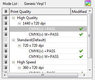

Look in the Media Explorer under the media menu in Versaworks. Choose the media in the left pane and look for 'W +Pass' in the right side. See attached screen capture.

Is it me or do you not have any pinch rollers holding down your material in the center?
That could be your problem right there. Material is not held down consistently accross causing it to lift in the center.
Patentagosse
'Never used center pinch rollers to avoid any marking or contaminants to touch the surface. 'Never had a single issue related to that before. I'm looking very very closely in the middle of the print area, the vinyl is moving forward freely, smoothly, w/o a glitch.

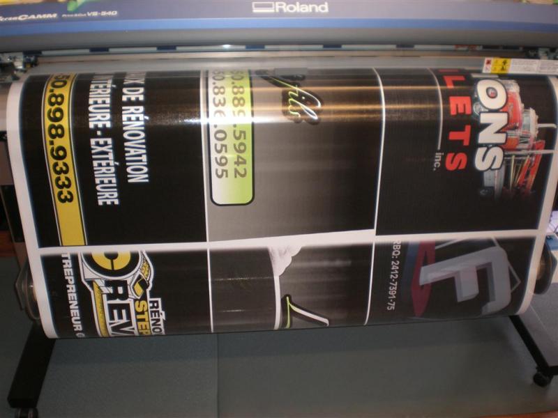

I've swapped the centre image to the edge, turned it 180° to had the gradient light side on edge - dark side next to the solid black background of the other file. After 1/3 of the print done, it's perfect. 'Hope it will stand that way 'til the end...:cool:
Patentagosse
Damn it! everything went smoothly but 10" before the end, it did it again. The customer will have to live with it as I've already ruined too much material & time on this.
