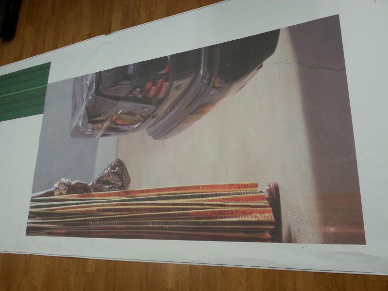

Epson GS 6000 running Colorburst
This started towards the end of this print. It did this one other time yesterday but at the start of the print. 2 times total so far....

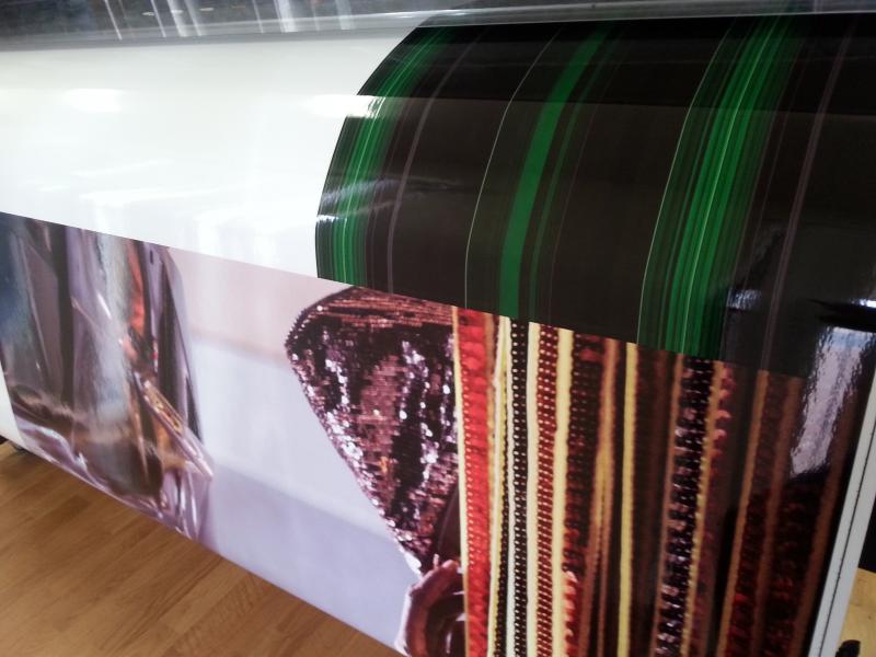

Rotated the image and still did it at the 6' mark. 25% size does not do this, then enlarged in the rip and this happens. :banghead::banghead:

I've had weird dropouts with Colorburst on the GS6000 - usually truncations and not corruption like that. In my case it was usually the eps file boundaries being smaller than all the objects it contains. I've had some similar issues with Onyx and the S70, but it was because I had downloaded a profile for the wrong RIP version. But to rectify that I had to reinstall the software, not just delete the printer.
mpn

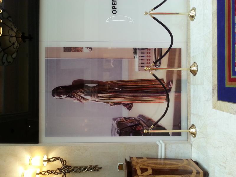

I'm not sure what fixed it, but we cleaned the encoder strip, re-installed the rip, new usb cord etc. Also cooled off the shop with the a/c because the static seemed high. Job was completed on time.

Our problem was a static issue combined with a bad usb cord.
Tim Miller
We found that the encoder strip caused a lot of these sorts of issues. It needed cleaned regularly, and we ended up replacing one of them.
