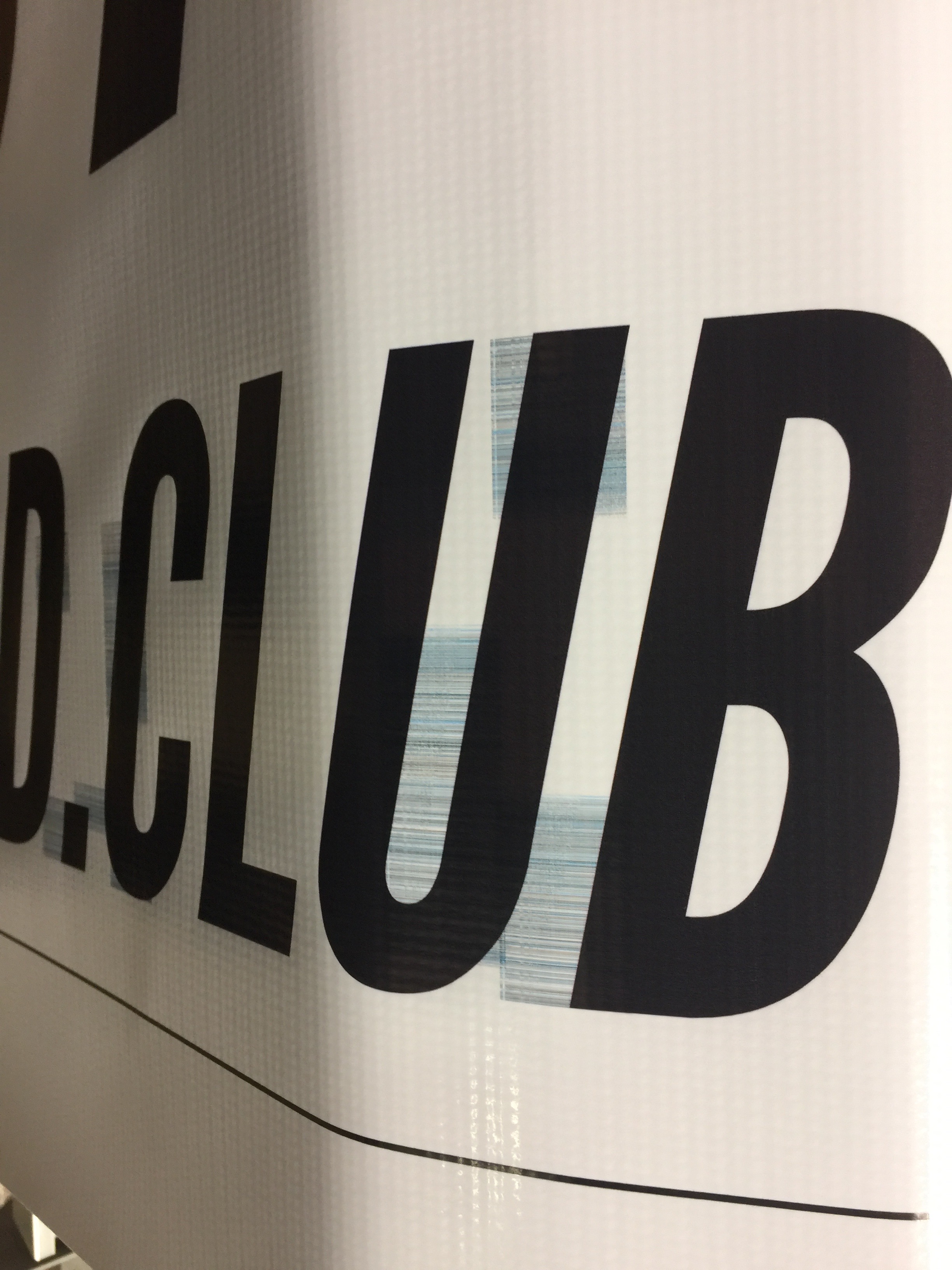

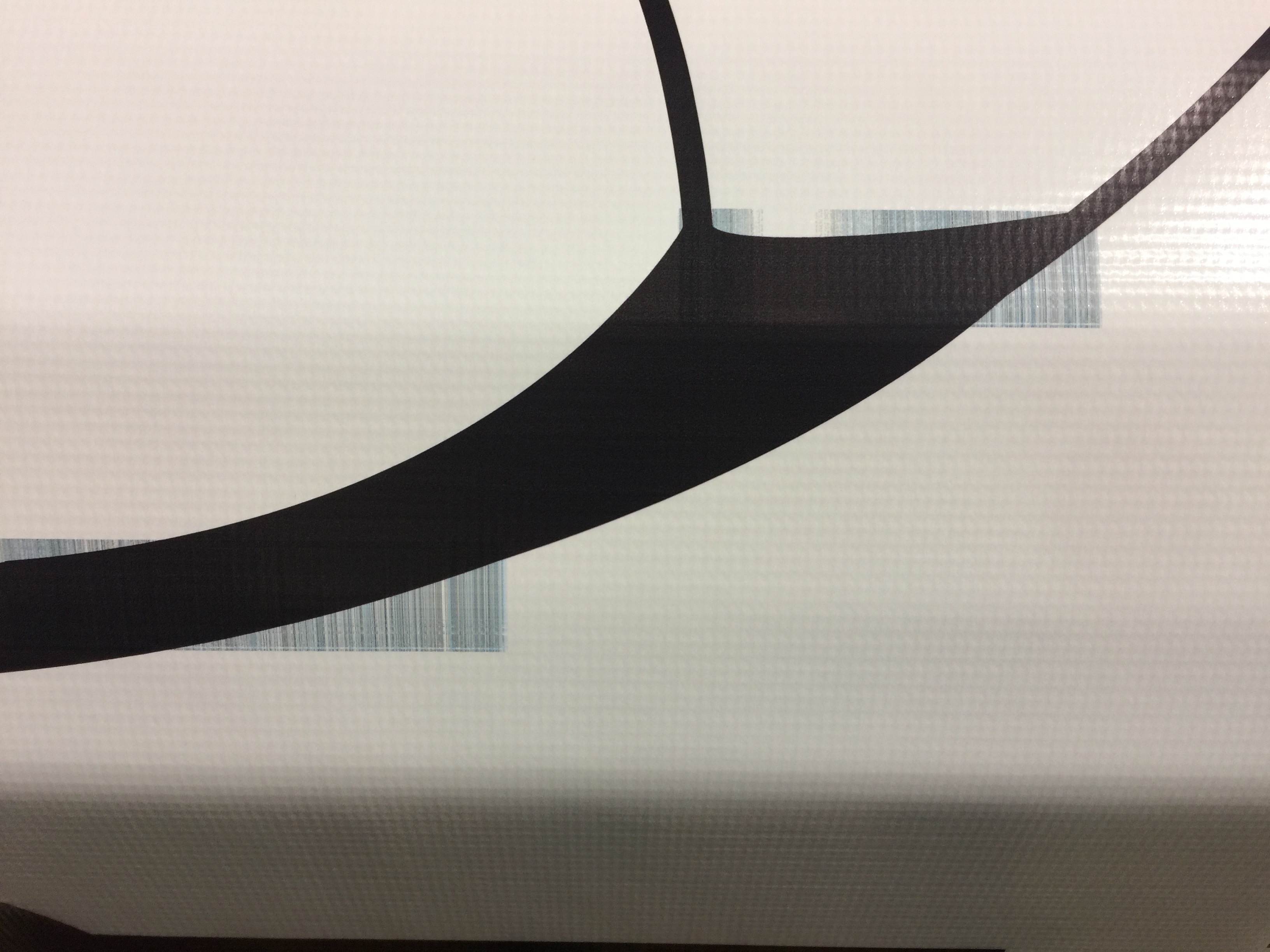

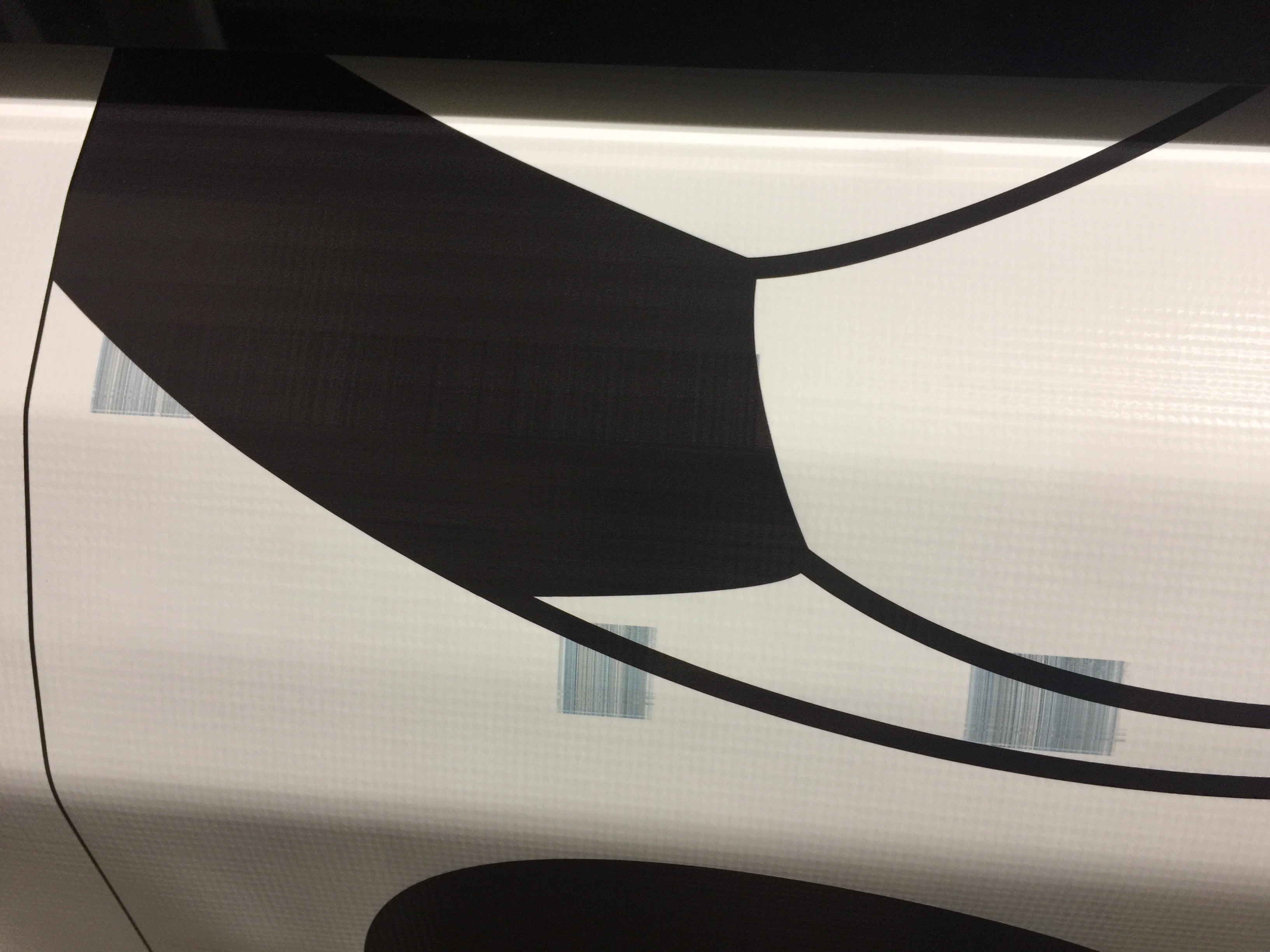

Getting weird glitch banding on one of my Mutoh 1624 printers. Seems to happen more frequently on fast printing jobs (like banners), or when attempting to rip and send more than one file at a time. Only happens on the one printer. Anybody else come across this problem and have a solution?
thinking that it's something to do with the cabling? either ethernet or possibly the head cable.

You are on the right track. Those patterns are created by the amplification circuit malfunctioning intermittently which usually means a bad cable somewhere. Check your head cables and make sure they are not damaged or dirty. Sometimes they become corroded as well. You can try to clean them with alcohol but it's best to just change them if they are bad. If they look good, then it's most likely the trailing cables AKA CR cables. Sometimes you can troubleshoot the issue by taking the top, center, long cover off completely. This will expose the CR cables. Run the printer like that and see if the issue goes away. If it does, then the cables need to be changed eventually.
