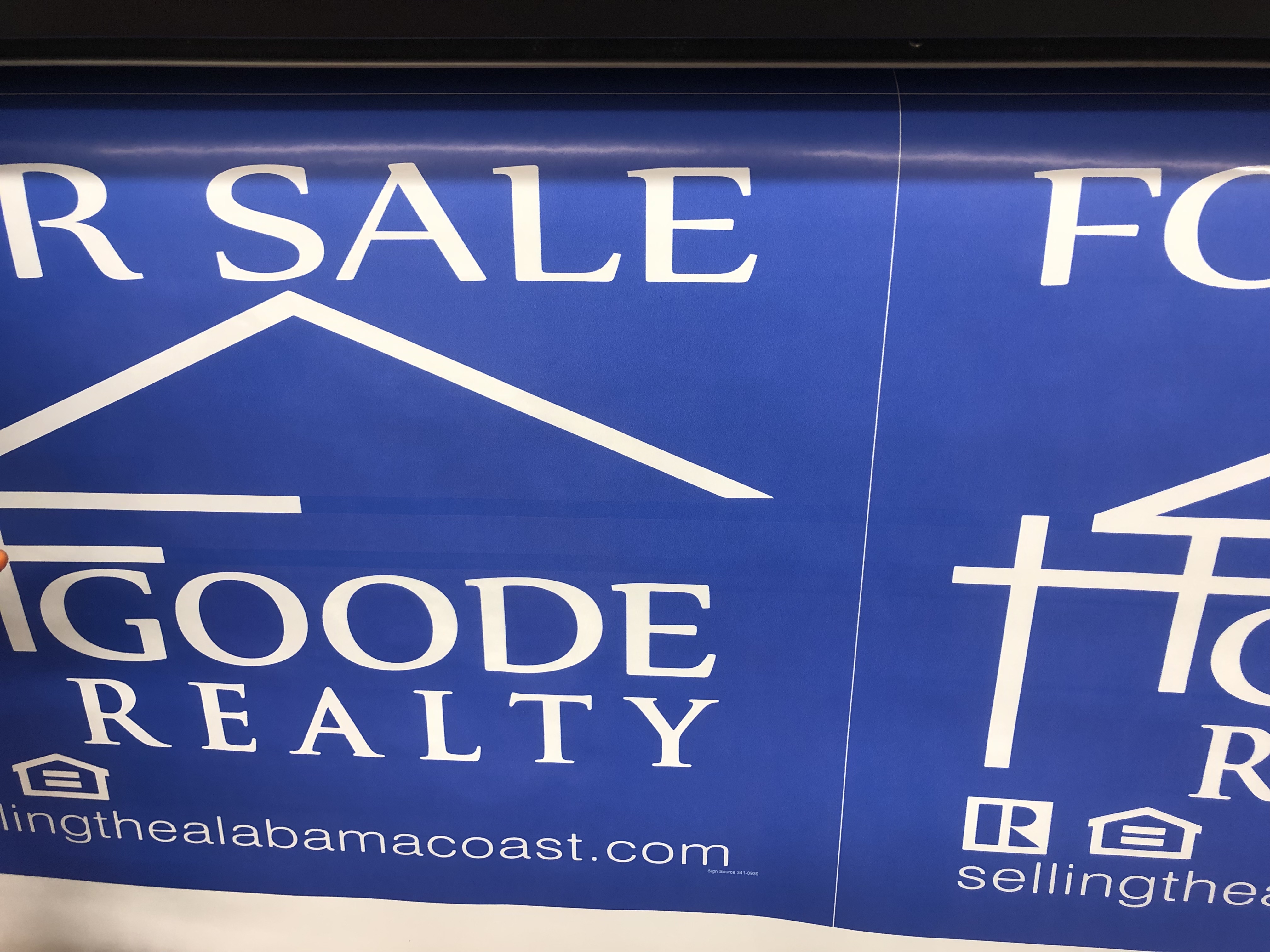

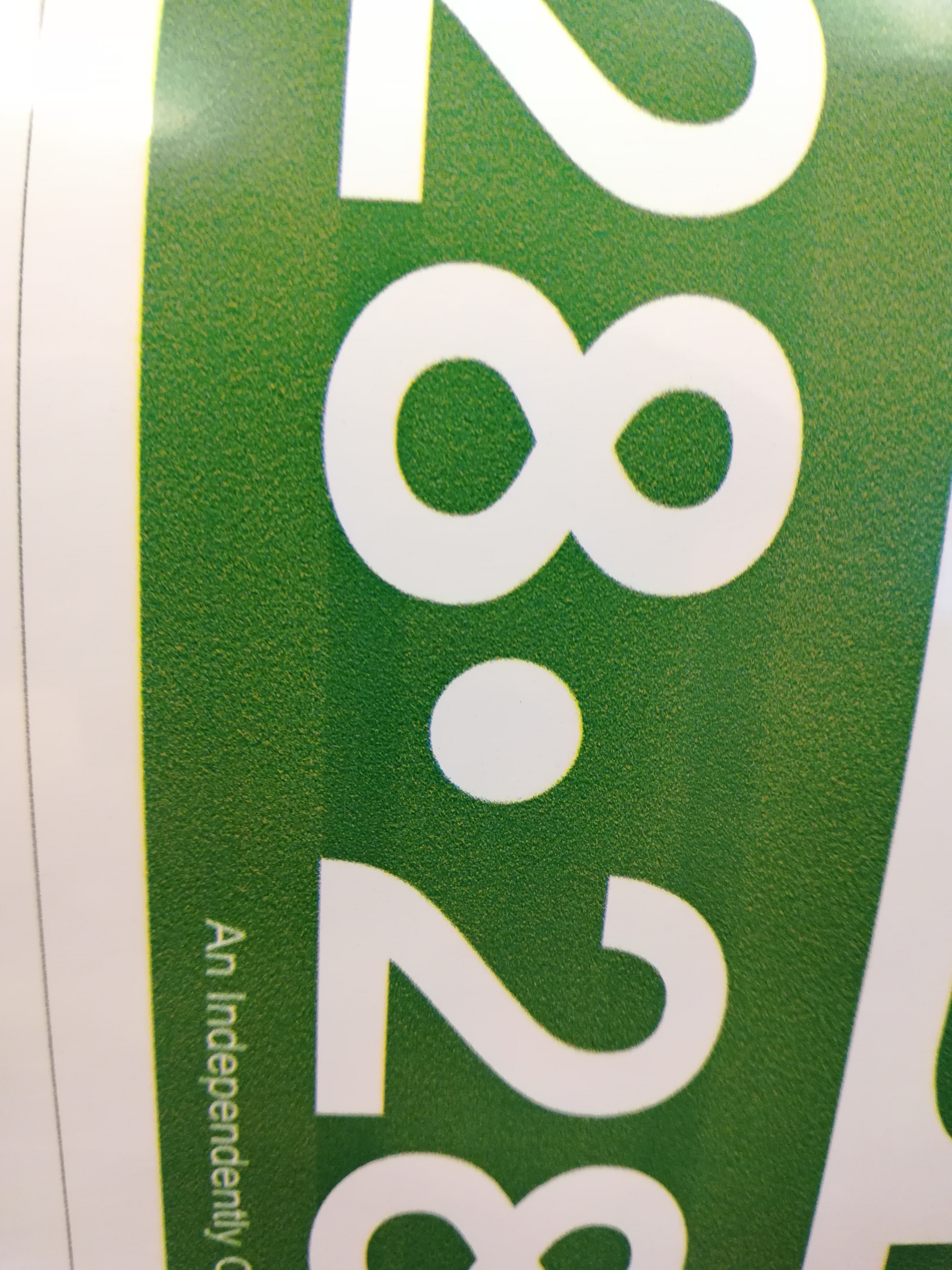

We just started getting these lines in our prints on the HP Latex 310. Only horizontal. It's like the negative space "casts a shadow". I'm attaching some pictures. It doesn't matter if we rotate the file before printing. We have changed the printheads too. Any ideas? IMG_0757.jpg IMG_20190827_151607.jpg

Align your printheads. Clean the line sensor, funnel and carriage first. Then after alignment build a new profile.

Cyan/Black (1 of 2) print head is going out , or Lc/Lm print (1)
One of the 3 heads need replacement.

Looking at your issue, this is caused by thermal lag on the Printheads.
Your options are the following;
1. Add interpass delay into your advanced settings inside the printer profile.
2. Add confidence strips to each side of the print.
3. Check the life of you LM/LC Printhead,
4. Print in a slower pass rate, 12 pass preferably.
5. Also clean your line sensor and complete a Printhead alignment, the graininess of the image is a miss drop.
