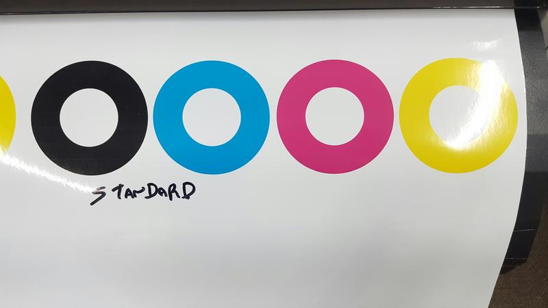

Did a little testing and finally found where to see what the rip is showing the output color to be. I created 1 document that had 4 3" circles with a 1.5" white cirlce in the middle. I set each of the outside colors as one each of the primary colors, yellow, cyan, magenta and black. I then printed one with the normal settings then i printed another with the color rendering set to no color correction here is the outcome.
Print 1 - Using default color correction. Images print corect color, Bright yellow, Pure magenta, Pure dark black, Bright magenta blue
input color black as rgb 0,0,0. rendering color or color that rip sees it as - 62,68,56,60
input color cyan as cymk 100,0,0,0. rendering color or color that rip sees it as - 70,0,6,0
input color magenta as cymk 0,100,0,0. rendering color or color that rip sees it as - 0,87,15,0
input color yellow as cymk 0,0,100,0. rendering color or color that rip sees it as - 0,5,67,0
input color white as cymk 0,0,0,0. rendering color or color that rip sees it as - 0,0,0,0
I get specks in everything along with the white in the center

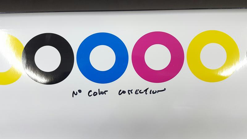

Print 2 - Using no color correction. I have no specs in colors and no specs in white but the colors look to print way to heavy and blue is a dark blue, Magenta is to dark and has fish eyes in iut like it to heavy and yellow looks a little dark and has fish eyes as it is to thick or heavy as well and black looks heavy
input color black as rgb 0,0,0. rendering color or color that rip sees it as - 0,0,0,100
input color cyan as cymk 100,0,0,0. rendering color or color that rip sees it as - 100,0,0,0
input color magenta as cymk 0,100,0,0. rendering color or color that rip sees it as - 0,100,0,0
input color yellow as cymk 0,0,100,0. rendering color or color that rip sees it as - 0,0,100,0

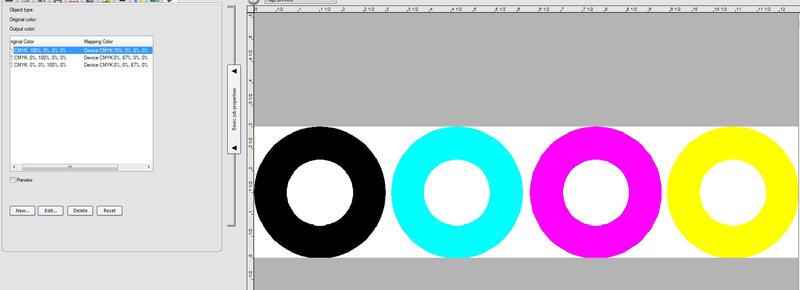

Print 3 I mapped each color to read exactly what it should be, The 100% cmyk values for each color and the cyan looks darker than it should. Like a darker blue. Unless i have a complete misunderstanding of the cyan being a lighter color than i think it should be.
Still have a few specks in the white in all prints so guess i have a head issue? Could this also be the reason i get a darker magenta and cyan than what it should be?

Tried one more thing. Did another print by thinking about the way the material and the profile worked together. It got me to thinking that maybe the 100 of the solid colors was to saturdated therefor making it to darl. So i went back to see where the rip was showing that it was sending to the device and i took out the odd color and left the solid color mix the same.
For instance. The softare showed the cyan to be 100,0,0,0, but it was being ripped as 70,0,6,0. So i took out the 6 and left the mix as 70,0,0,0. I did the same for the other colors and it have VERY VERY clear clean colors and no spec or very few specs in the white but no specs in the , yellow, cyan, or magenta.
I guess this will be different for everything that i print? Media wise.

Try this. Do another print just like you did with Print 1, except this time before you send the file to the printer put a check next to "white" in the Color Settings\Rendering Intent\Pure Hue\Preserve Pure Hue window. By doing this I think you are telling the rip to use "no color correction" only on white. The other colors, CMYK, should print the same way they printed before. Just like you, I never use "no color correction" for my prints. That throws the colors off. By not using '"no color correction" my 1204 prints really good looking Pantone colors an I certainly don't want to mess that up. By the way, to print a really good tomato red, I use RGB (255,20,20) and always check RED in the Pure Hue window. Hope this helps you out. It works for me.
altereddezignz
So on the pure hue screen only select white in pure hue and leve all the other settings as default but change my mixture that the rip is sending to the device to remove the odd color as in the yellow or cyan i listed above?
altereddezignz
ok i did that with changing my mix to remove the odd color added and i turned on the pure hue for the white and seemed to fix the issue. Now my black is horrible looking and i didnt change anything there. UGH... So sad haha
