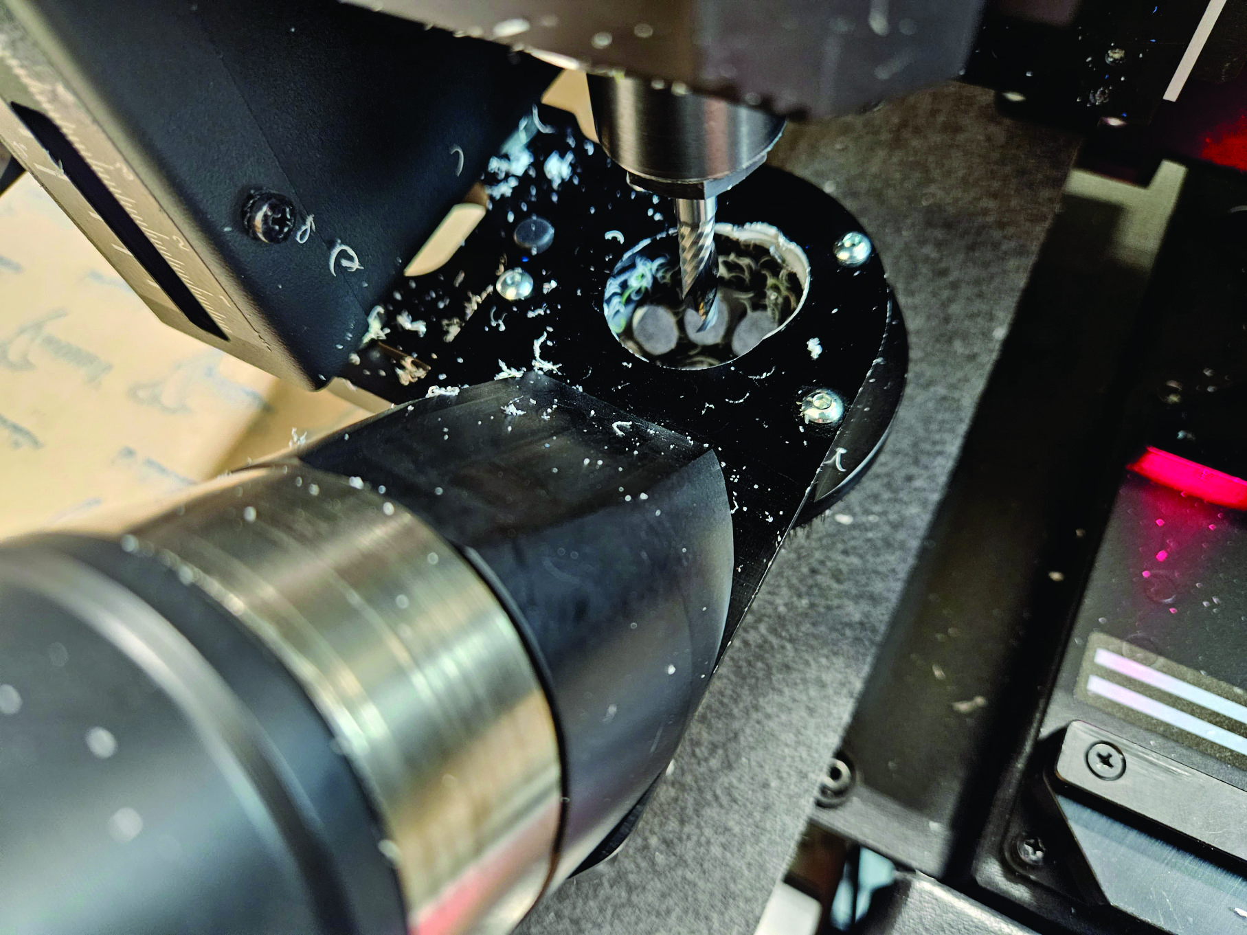

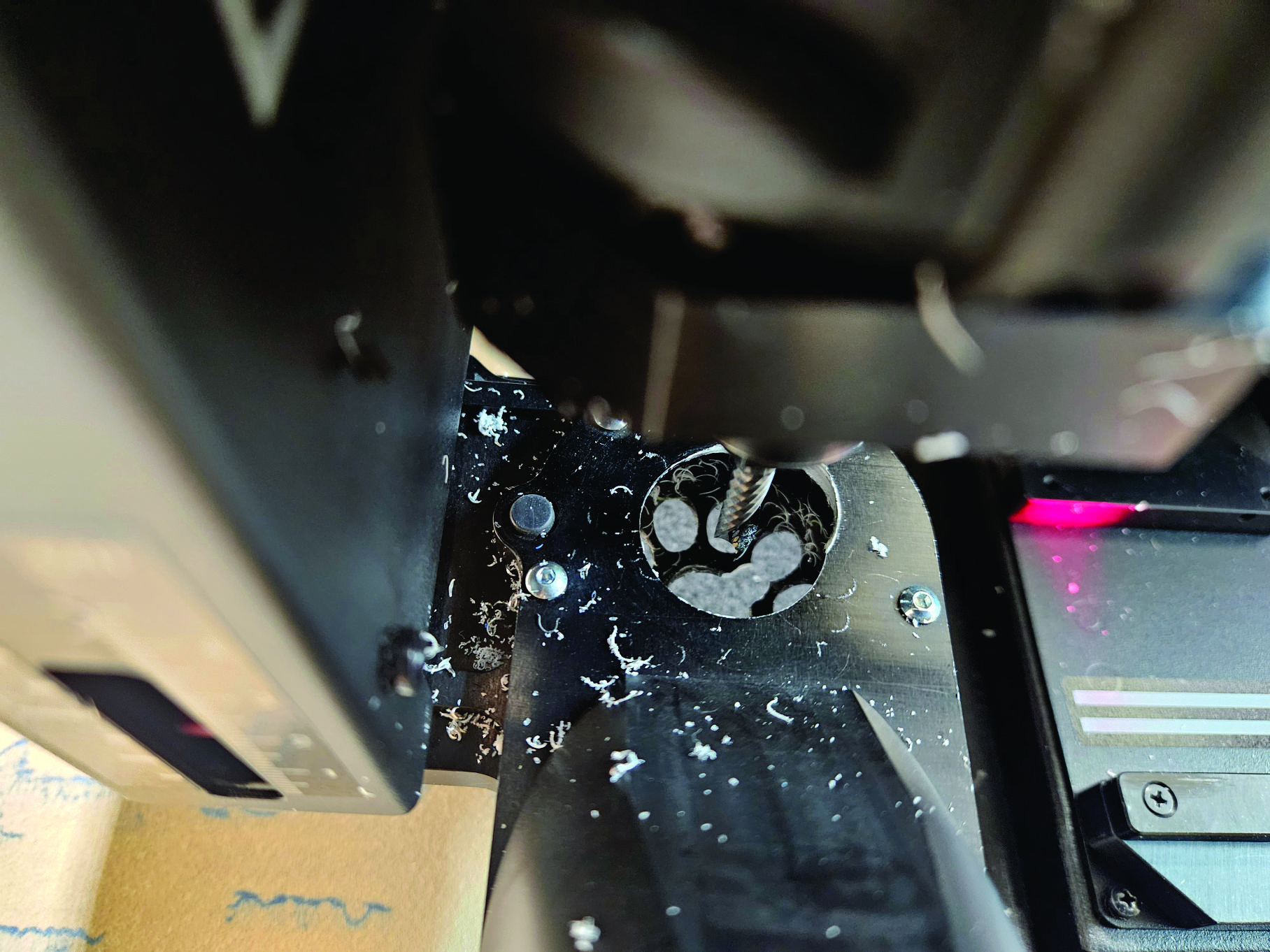

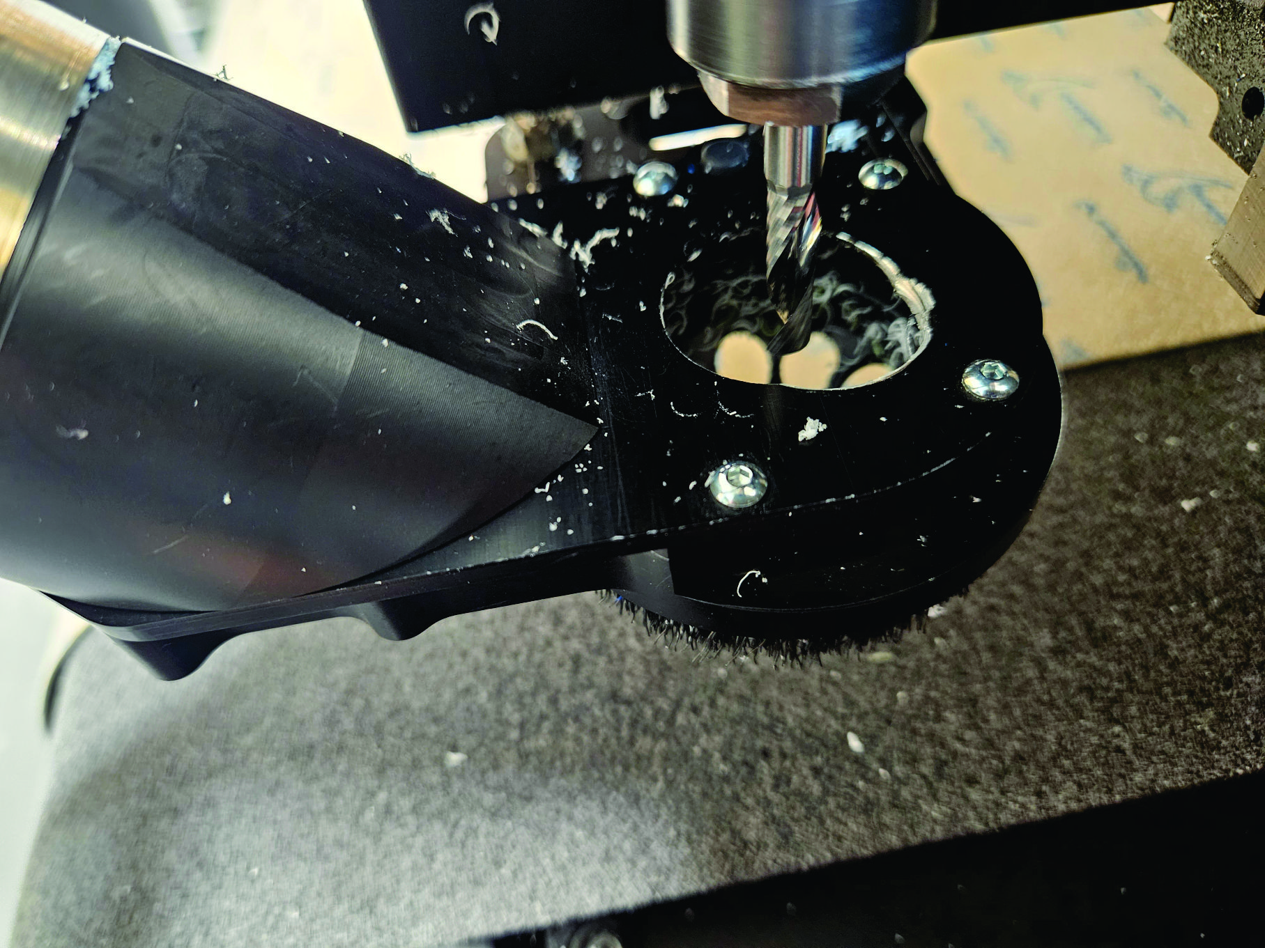

We were routing some 1/2" gator foam this morning (anyone else cut this stuff with a router?) and somehow the dust boot jammed when doing a sheet cut and the bit actually carved out a chunk of it.
I can't wrap my head around how this is even possible. Other than the boot being chewed up and some aluminum shavings melted onto the collet, everything seems fine and we're been routing since the "event"
Using a 6mm single flute Upcut bit.... no way it could've flexed enough to reach a 1/2" over and do this damage. I tried to see if the dust boot bracket/assembly has any give to it and it really doesn't.
Any theories? I might send this to Summa and see if they can explain how this is even physically possible.
So far my only guess it's that it's due to this being a last minute rush job. :peace!:
I'm not even mad, just confused.

You'd be surprised both how much deflection a bit can have before breaking, and how much force the motors on a gantry moving at full tilt can produce. I'd wager it only hung up the boot and it bent until the router got it.
