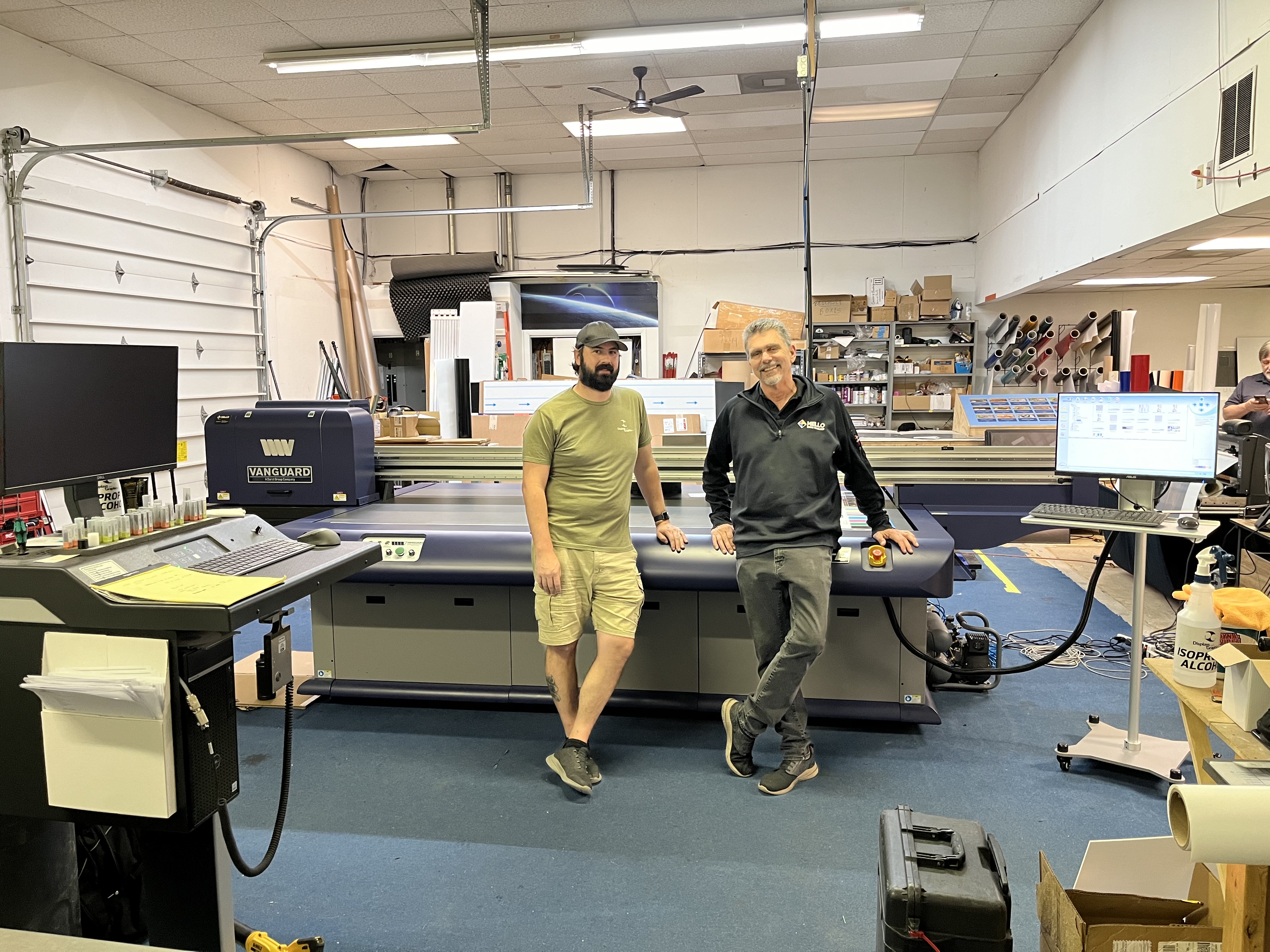

I just finished training on an affordable Vanguard VR5 with only 2 heads and was able to set it up and build Onyx profile for it to run in High Speed Carriage and 2 pass to print 4x8 in 4 minutes!
