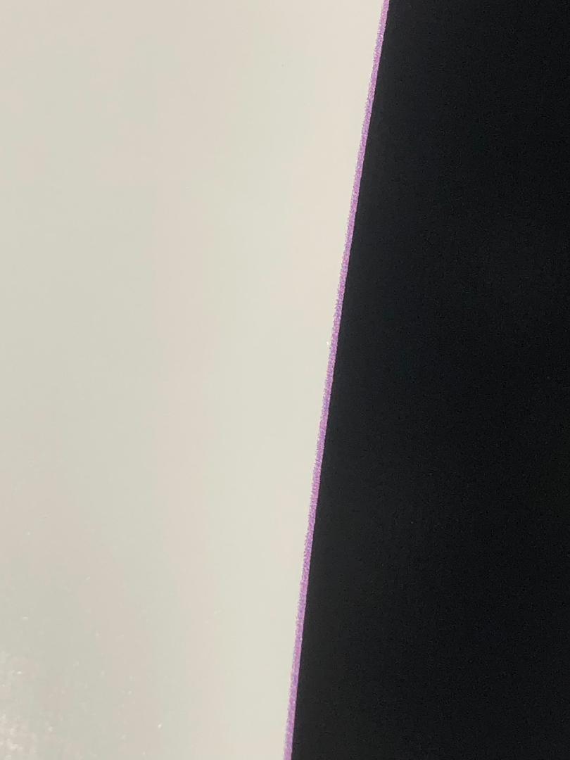

Our pretty new Roland VG-2 just started printing these little "halo's" along the outside edges of the prints. The feed calibration and media gap adjustment (bi-directional) are all calibrated. Nozzle tests are good. The user manual doesn't suggest much beyond those two adjustments. Any insights are greatly appreciated. Thanks!

Could it be contour cut lines that were done improperly? Check the for the line in in you vector design program, the swatch may be misnamed. Also, if it is a cut line, it looks like the jackwagon who made it did not bother to bleed the black to account for any variation of the physical cutting that will likely occur.
