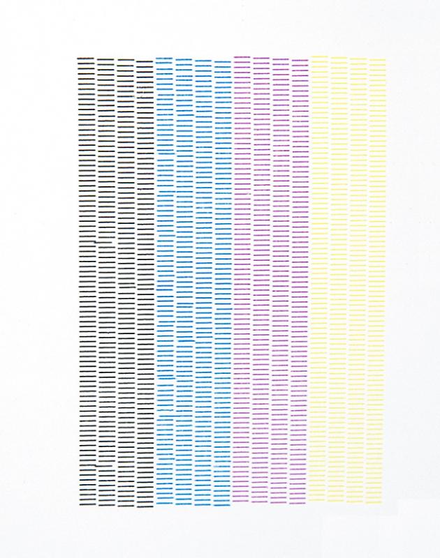

What causes Deflected Nozzles?
I have NOT had any head strikes, I think my cap-tops are bad and causing my heads to dry out.
What is the BEST way to FIX deflected nozzles?
I did a head soak, but that did not clear the deflections, any advice appreciated.

Deflected nozzles are far harder to fix than clogged nozzles. Worn Captops are a prime cause of both issues (along with worn wipers), which is why Roland recommends that they be replaced between 1 - 2 times per year (they are user-replaceable). The SP series share the K and C channels on one head & captop, and the deflections look to be entirely on that head. Cleanings by themselves will rarely resolve this type of issue, and head soaks combined with cleanings are iffy at best.
Running cleaning solution directly through the head (using a syringe from above) is the only semi-reliable way to clear them, however it is possible to damage the head if too much force is used, so you would need to be careful. Frankly, the amount of nozzle deflections that are present are not enough to cause visible defects in print output, so I would not proceed with the syringe at this point.
