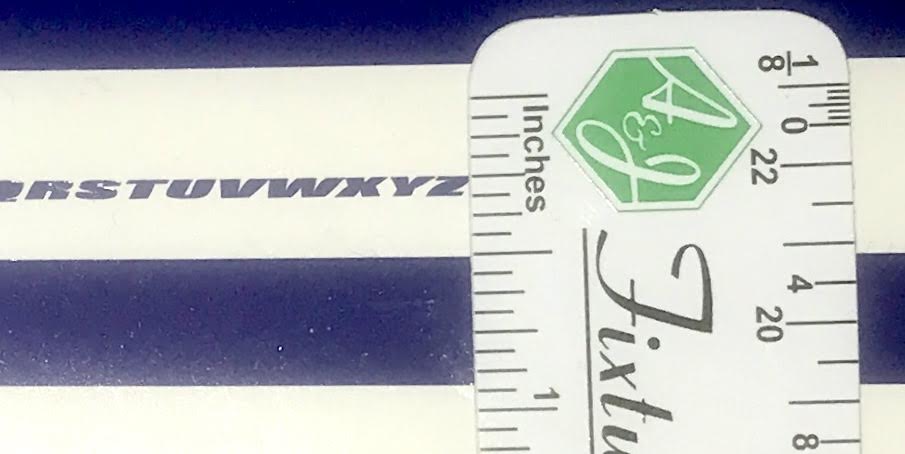

i run Graphtecs all day long.. 8600-130's and 30' plotters as well and i run a 45 degree blade all day long on cast vinyl, calendared vinyl, vinyl paint mask & printed & laminated contour cut graphics.... I get years out of a Graphtec 45 blade.... If im cutting reflective a lot, ill swap out another dedicated 45 degree blade but i never use a 60 blade... I even cut this small on my plotters...

Thank y'all for your input. 45° it is. I'm also impressed with Von's small cuts on his Graphtec.
