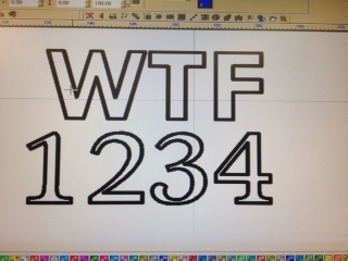

Can someone please tell me what I did. My power went out while I was working in SignLab (7.1). When the power came back on, all fonts have a thick outline. Alt S will fill the letters but they cut with the out line. What do I need to do to get the fonts back to normal?

In my version there is an outline/fill colour switch at the front of the colour pallet bar at the bottom. My guess is this has been toggled. If you select "clear color" from the colour pallet the outline should disappear. Then toggle the outline/fill switch back to the fill option and select the colour you need it to be.
