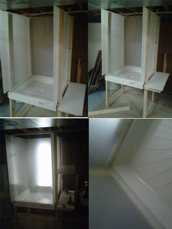

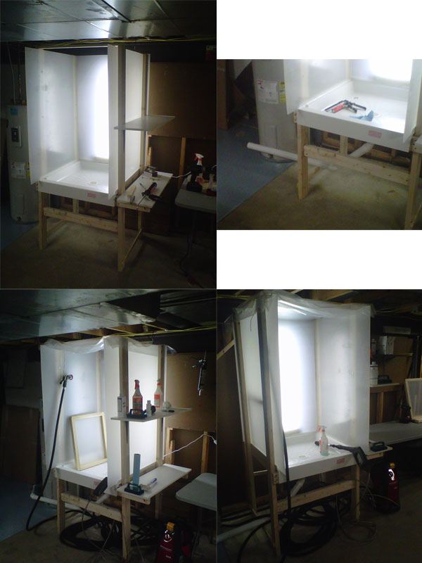

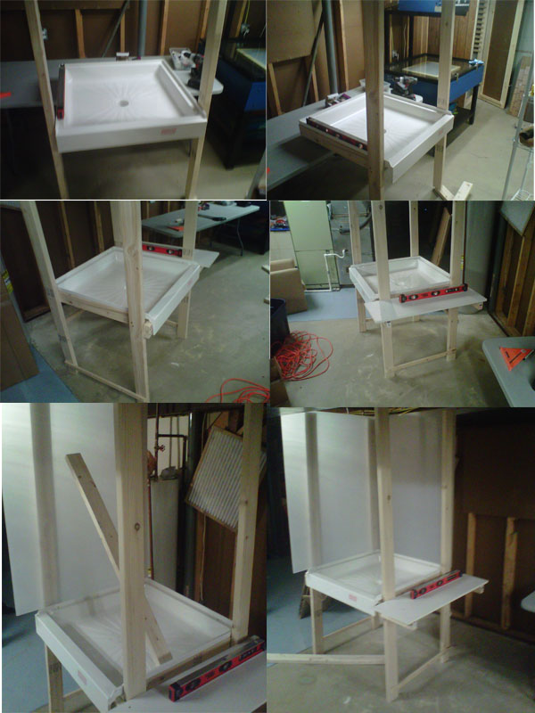

Finally Getting a dedicated dark room. as such Im building my own washout booth. what do you have in your washout booth that's helpful? or think would be helpful?
