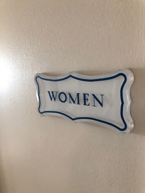

Question What is a good company to outsource custom ADA sign?
nolanola
https://manhattansignshop.nyc/
We would like acrylic and for it to include braille. It has a custom shape and font and color.
