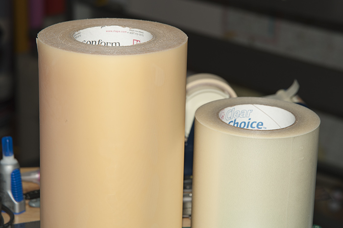

I have a older roll of R-Tape Conform series (says with RLA release liner adhesive), no product number in the core, it has a kind of textured (grid) surface on the top. The roll has turned a bit yellow over time, I don't know what the product number is, however it does work for these decals much better, it just doesn't look good - Yellow.

Hmmm...our roll of AT75 is clear, more or less. It's got a slightly hazy white appearance, but definitely not yellow, although yours is perhaps yellow from age. Also, the AT75 is from the Clear Choice line, not the Conform line, so you might have something altogether different there.
I would definitely give the AT75 a try. They will usually have no problem sending out a 6" sample roll to test. 90% of what we use is the 4075 and 4076 Conform series, but the AT75 is pretty decent when a clear tape is needed. After reading on the RTape website about the three Clear Choice options, I guess they claim the AT65 to be high tack, also, but I beg to differ. Apparently so does our supplier, because they call it medium tack, which sounds about right.
