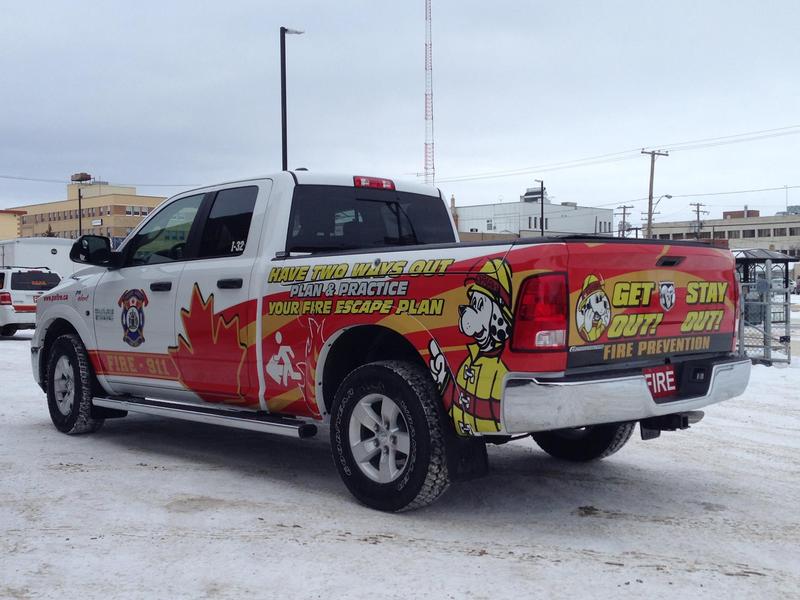

This one i did last year was done with 5650, never had a single issue with it during install.
attachment.php
