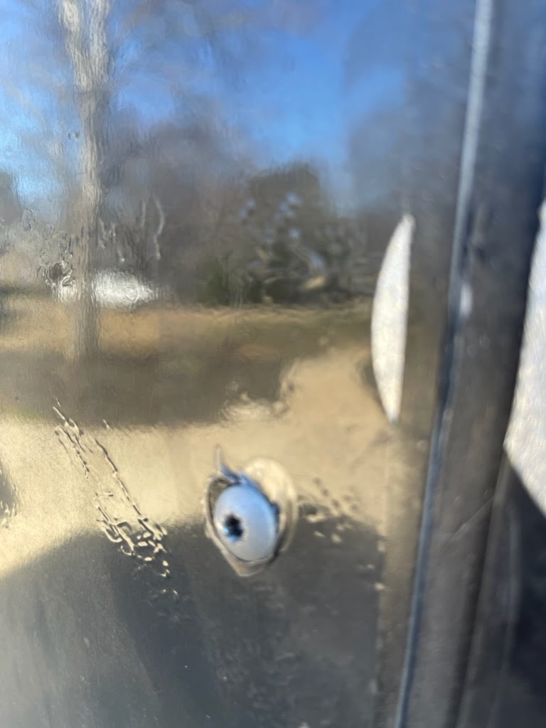

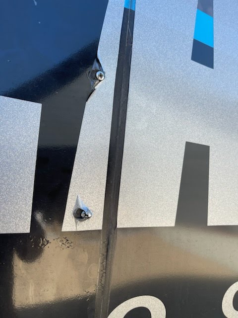

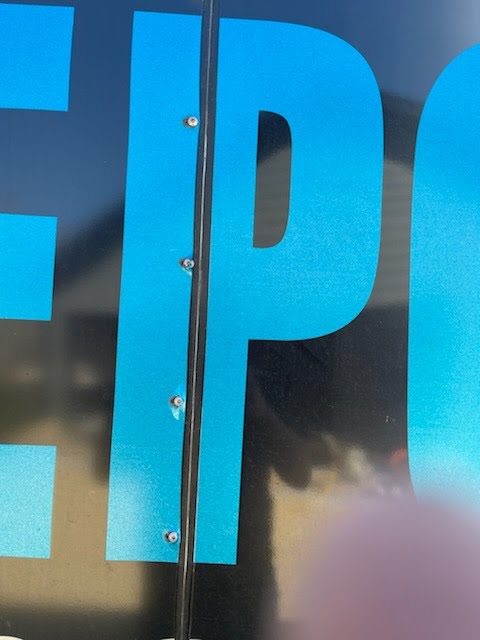

This is HP Gloss Polymeric Overlaminate from Lexjet and its shrinking big time. My question is this entirely the laminates' fault or since this is a solid color print of latex ink from an HP 315 printer, is it releasing because of the ink, or just low-quality HP laminate? I know that the new HP printers 700/800 use a different kind of ink that let you turn off the scratch resistant overcoat for when you are laminating a solid print so the laminate will stick better so is that indicative that the ink may be the culprit in this case? You can actually see it pulling away from underneath the screws! The blue and silver are metallic vinyl applied OVER the laminate.

That's a calendared laminate. that is the problem. You need a cast laminate.
Reactions: 8 users
2B
100% WRONG lamination!!!!
That link you listed states this is calendered
The shrinking is only going to get WORSE.
210 is also a calendered film and turns "yellow" with UV Burn EASILY, all while shrinking A LOT
ONLY use CAST on vehicles!!!
The only other laminate suggestion is 3M 8048, for SHORT term and flat surfaces

Well there ya go! I have a recommendation for 3M 8048G is a 2mil gloss, calendered, non-pvc overlaminate that is suitable for flat or simple curves to replace my calendared HP laminate because it shrinks. Then the recommendation for cast only vinyl still leads the pack. Which begs the question, what CAST laminate is cost effective?
Thank you for telling me about the Oracal 210 turning yellow (burn). I've seen that on a lot of signs around town and just attributed it to cheap Chinese vinyl.

Lamination :) optimal lamination occurs with a minimal combination of FOUR things: Pressure, heat, time, and tension. Typically with shrinking film, especially after a short time many times there is too much tension on the feed roller. Should be a "dial" which controls a spring on the feed roller. Tension should be set very light, just enough to provide a little resistance during feeding.
So, heat up the vinyl a little, and add too much tension on the feed roller this will definitely stretch the top film during lamination. Then the vinyl wants to return to its previous thickness and BOOM shrink.
Another good thing to remember and this happens over longer periods of time; laminating different products together like cast vinyl films with calendared films will result in different expansion and contraction amounts during temp changes. Again, causing shrinking or separating of films.
