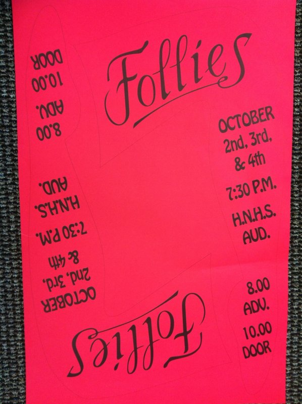

Apparently the company that used to print these (just a general paper printing company far as I can tell) isn't printing them anymore, so they came to me for a solution. It's basically a one month promotional for a community fund raising event. They get the people involved to cut them out by scissors, and follow the black outline. It's just got to be 23" X 35" or so, and black ink on red paper.
I have checked w/ Mike @ Merrit, and I'm waiting to hear back if the blueprint guys can do this or not. Anyone else know of a wholesale online source? Got print could do them, but I only need 150, not 500.

traditional offset 1-color on red stock? Quantity is probably too low though... Does it have to be black on red or can it be a 4-color print on white (i.e. inkjet print the whole thing, but the backside would be white instead of red)?
It can be a four color print as far as they are concerned...these things were total crap in my opinion...colors are a terrible combo, and they faded after being in stores windows for like a week. I have no clue what they paid for them before, so I didn't even know rather to get involved.
I'm not against Kinko's I guess...I just have never ever been there, so wasn't sure about it. They need 300 "legs" total, so yea, 150.

what you want is 1 color offset on red paper. 23 x 35 is one of the most common sizes for an offset paper. 150 is a bit on the low side but its a quick easy job for an offset printer. I bet you can get it done for a couple hundred dollars. You can probably double the quantity for $50 more. Offset would be the most affordable way to do this by a long shot.
Salmoneye
Offset, any commercial printer. 1 plate, black ink, doesn't get any easier. You will pay the minimum set up charge 150 or 1,000 will probably be the same price except for the stock (of which there might be a minimum).
