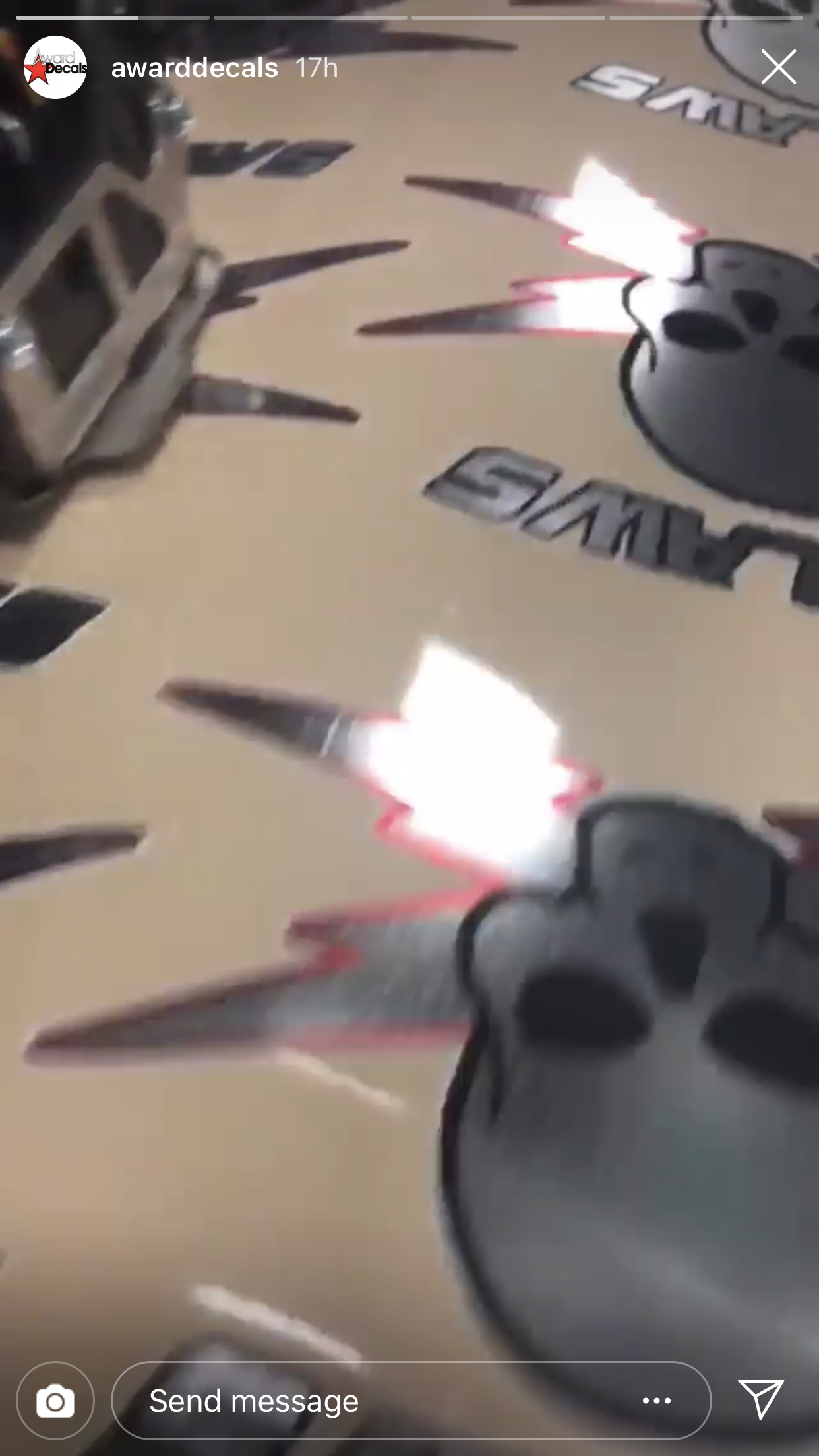

What machine to print this?
artofacks1
What machine does gold like the edge but with such a large foot print?

Silver Metallic in a Roland VSi or XR printer will do that, plus mix with CMYK to get gold, bronze, and other metallic colors, but it is really slow to get that quality and you can only get it on gloss vinyl without a laminate. Once you vary from that formula, the polished quality diminishes greatly and it's not considered durable outdoors.
Just looks like a mylar that has been digitally printed and contour cut. I don't think the silver was printed. It looks like it's already been weeded.
