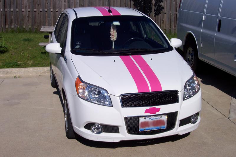

Yummy, bubble gum pink racing stripes. Did this last year. My first and only pink racing stripes. Definitely go cast.
