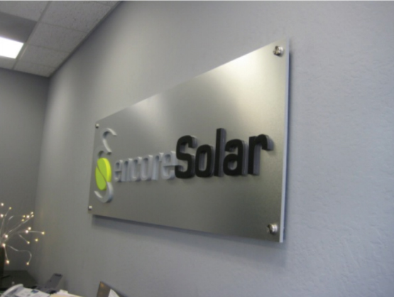

Looking to make a similar style sign to the one attached. Trying to figure out the best way to do the backer with a brushed aluminum background, and 1/2" thick. Can you get gatorboard with that finish? OR would I glue a thin sheet of brushed aluminum onto gatorboard or PVC?? Thanks for any help.
Signed Out
I guess acrylic would be better than gatorboard or pvc. But is there a substrate out there that already has a brushed aluminum finish?
ams
Everything comes in 1/4" for that, I was able to find 1/2" and 3/4" in it. It's called "Ultra-Aluminum Polished Chrome". A 4' X 8' sheet only weighs 9 pounds.
henryz
The backer looks like 1/4" brush aluminum but you can achieve the same look using 1/4" acrylic paint the edges or polish and apply .040 brushed aluminum wrisco. Letters can just be fco. The standoff look like stainless but aluminum look good too.
signbrad
We do a lot of this type of sign work. We commonly use 12mm PVC or half inch acrylic face-laminated with Brushed Silver Chemetal or a similar laminate. Use contact cement, water or solvent based for laminating.
Use a sharp fine-tooth carbide blade for cutting the panel or use the router table. Matthews "Brushed Aluminum" paint for the edges is an excellent match to Silver Chemetal.
We then flush mount PVC flat cutout letters that have been painted. Letter thicknesses range from 6mm, 12mm or thicker. For letter thicknesses greater than 1 inch, we stack the PVC.
Acrylic works fine, too, for both panel and FCO graphics, as do other substrates. There is no wrong material, in my opinion. We have experimented a lot. Even Gatorfoam brand foam board will work, too, but it is not as problem free. Edges must be carefully sealed before painting with a paint like Matthews. Also, while Gatorfoam has a good reputation for staying flat, it can curl if laminated on one side only. And, of course, a foam board is more tender, susceptible to damage. PVC seems to be an ideal substrate for interior signs like this.

AMS' response about Ultra aluminum is correct. The company is called Ultraboard and the website is ultraboard.com and the product comes in gold and chrome.

Agree with Signbrad, we usually make the same type of sign with acrylic or pvc and a brushed metal laminate. You could also use an aluminum composite material such as Dibond that comes with a brushed aluminum finish. you can get it single sided or double sided with aluminum facers and a polyethylene core. You could paint the edges with a silver metallic paint so that you don't see the core and so that it "matches" the brushed aluminum finish.

Hi, I'm looking to make a similar sign except without the PVC lettering (going to just use vinyl lettering instead). How does the 1/2" UltraBoard Aluminum do with bowing? Looking to do something like 2'x6' or 2'x8' on standoffs. I'm guessing it'd need standoffs in the center of the sign as well (6 total)? Any insight or tips? Thanks.
