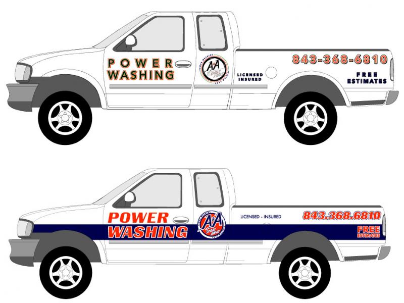

I posted my on spec redeux of a clients logo late last night. I also sent him the vehicle graphic layout below. The bottom is what I came up with, drawing on his initial color scheme but using the reworked logo in an effort to brand him better.
The top is what the client actually wants. He said my design looked cool...BUT he did not want to alter the branding already in place, which as far as I know is only business cards.
I feel it would be wise to make the change BEFORE branding a vehicle...but that's just me;)
Take a look...there are THREE outlines around the text, and in my opinion nothing has any impact at all.
Comments and critiques, please
Mosh

His design is bad but yours needs some work in both color combinations and legibility.
  • Lose the dark blue stripe. It overpowers everything else.
  • Change the colors. Blue and red near each other tend to blend together into purple.
  • Outlining is not your friend in this design.

Fred,
Yeah, I know on all counts.
Color choices were not mine...I would go with a more basic orange...this reminds me too much of classic Federal Express.
Outlines were left to appease the client, I would prefer clean.
The stripe I admit was my doing, it just needed something to tie it together.
As for hierarchy...he wanted the logo on the rear door and power washing prominent on the front...go figure.
Steve C.
I like the stripe ok, but the word WASHING and FREE ESTIMATES should be
in white, no outline. No outline on the phone #. I am guilty of adding too many
outlines and shadows sometimes also.

His old logo looks the same on the truck as yours shows up. If you want to up sell him you are going to have to have more going in the new layout. Sure yours looks a little nicer but the client needs more of a change before he will commit to it. And as far as logos looking like something else, the market has been saturated with a lot of "branding" look alikes. How about a cartoon guy with a power washer wand in his hand. I know bob likes that look.

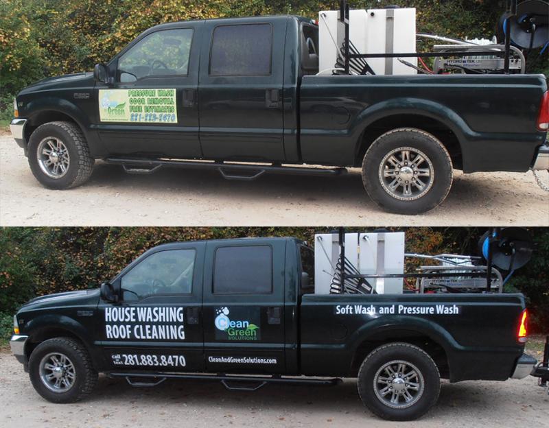

Tim4
Here is a super simple layout that sold more work for the client in one week than the old graphics sold the previous year.
what a pain in the *** to put back on straight when he washes behind those magnets every week and every time after driving on the highway like they are supposed to:covereyes:
Tim4
That's why he opted for the self-adhesive.
I did not claim that it was pretty, only that it was effective.
I do appreciate good design. I am just not able to create it.

Mr. Chip, that lettering needs work. Choose two colors, for example, navy blue and yellow. Defenitely no white outline and red outline - looks blurry. And try incorporating flow, instead of long line from front of truck use power wash washing device (handle) to letters and logo. The overall design looks bit ancient. If your client just wants lettering is ok, but needs cleanup. If he wants nice design pick one them fancy letterfonts and work from there. Ask Joe Diaz to help:smile:.
