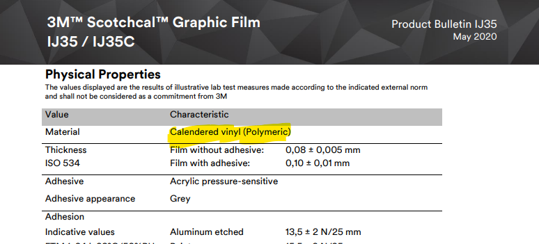

ikarasu
Calendared vinyl print media can be categorized into two types: Monomeric and Polymeric. Monomeric SAV uses monomeric plasticizers, while Polymeric vinyl uses polymeric plasticizers. Polymeric films tend to be more thermally stable, shrink less, last longer, and cost somewhat more than monomeric vinyl. 3M IJ35 is monomeric and IJ40 is polymeric.
I get to correct you for once! How the tables have turned :cool:
Ij35 is polymeric as well.... I don't think 3m Does anything monomeric.... At least nothing we use. Mono shrinks so much.
