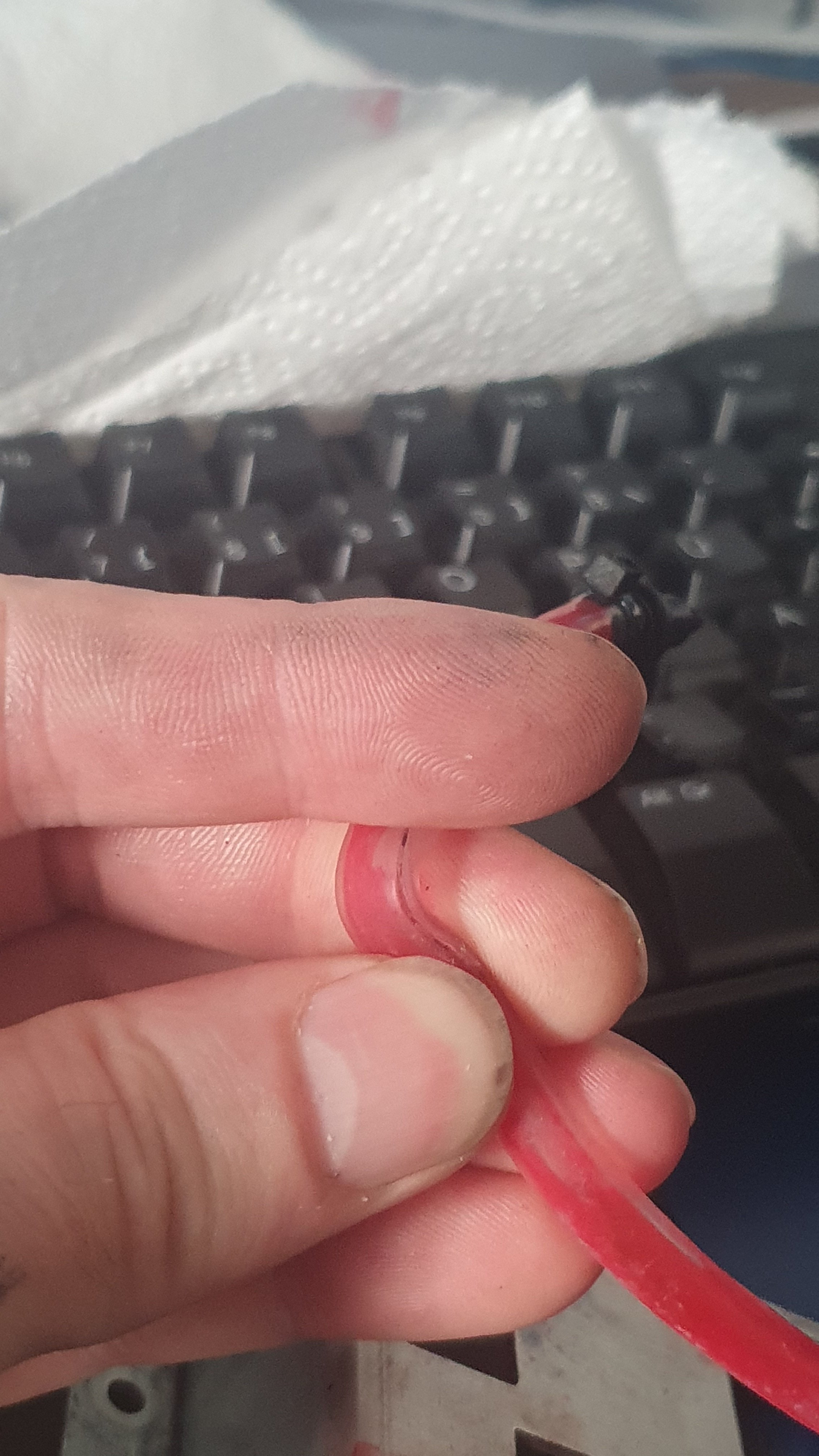

i buy a VP300 and must repair the Pumps, i buy these clear repair tubes from digiprint supplies.
I clean the pumps from lubricant and assemble it with new tubes and a syntetic grease.
Now after 3 weeks i have seen thats one pump have half of this power. I disassemble the Pumps and see thats the new Tube are broken on the side where the toothgear is.
The white teflon spacer is on place, the grease is everywhere in the pump but only a very thin film on the tube.
I think the grease was wrong, blow up the tube and let it break while pumping.
Now my qeustion i didnt found anywhere. Which grease is safe to use?
