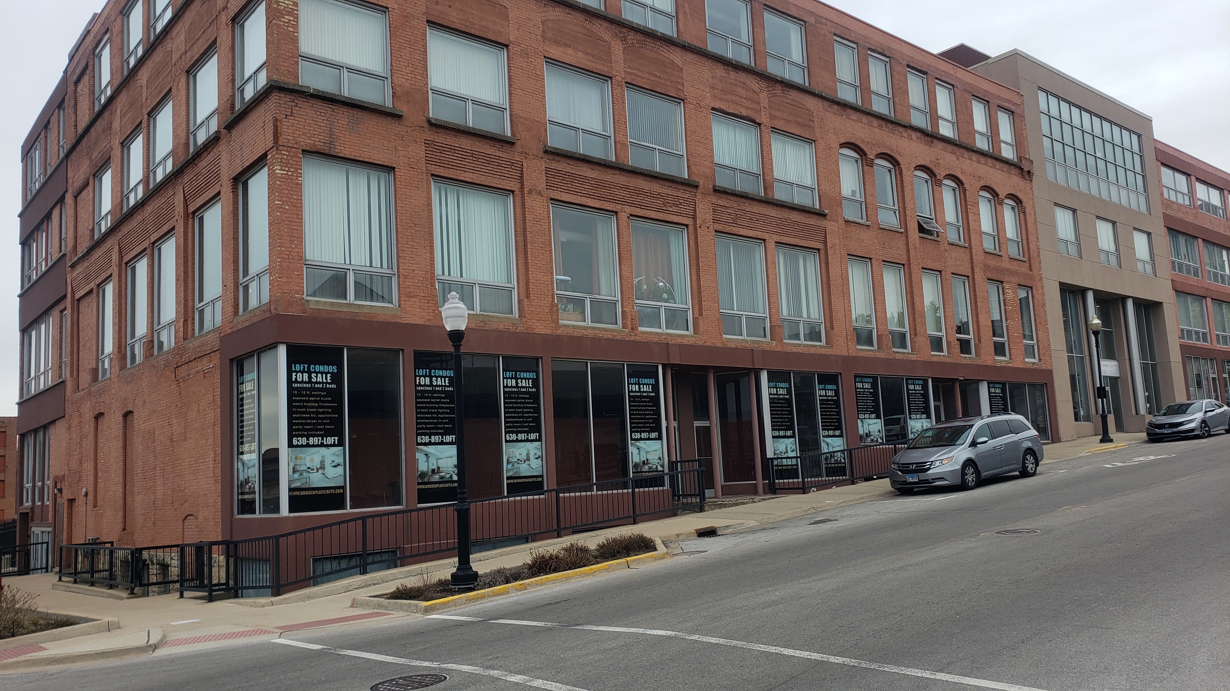

Hello Everyone,
I have a customer that wants me to replace the graphics they currently have, (pic attached for ref)
what's there right now feels like a window cling mounted on the inside of the windows, not sure how long its been there as its falling to pieces if you touch it.
so my question is what material should i use, inside facing window cling? I'm concern about durability as customer keeps them for a long time. i would normally tell the customer to go with vinyl/perf on the outside but the windows are pretty big and if you look at the picture there is like a basement so i don't even have ladders that big. i've done tons of window installations but always on the outside mostly perf.
any help is much appreciate it.
thanks,
Oscar.

I've got some options for you beyond the WindowTac (which I sell). Do you have a laminator? If so, I'd go with a clear removable adhesive and a white/white adhesive vinyl for your white point. Whether or not you want it to be completely opaque would be up to you.
The cheapeast and easiest route would be to use their 6mil white/white removable vinyl with air-egress and put it on the outside of the window. Will remove cleanly up till about a year. But if it has to be inside, going with the clear backed with white would be easy to install, easy to remove, and just a quick pass through the laminator.

yes i think I'm going this route. i do have a laminator. if job gets approved i will contact you for pricing on the WindowTac for sure.

Whoever originally did it probably did it on the inside because of that basement. Ladders would be pretty sketchy, scaffolding would be easier/ safer, if it'll even fit in there.
I'd put it back on the inside. That way if they ever want it removed/ changed again, and come back to you, it'll make your life easier.

I usually print mirror-imaged on clear vinyl (Oracal 3640, for instance) and laminate it in white Oracal 3640. It's calendared and as it's in a window, with the sunny blasting on it daily, you'll get 3-4 MAX whatever you put up there.

I'm betting whatever you end up using, you should consider the UV punishment it's going to take. Looking at that location on google maps and that whole side of the building faces South (and not much shade).
If longevity is your goal, see if you can work in some UV protection.

so the stuff they currently have there is window cling material, and it literally its falling apart just by looking at it, they had that stuff there for years, the picture shows a home and the tv is the old school big boxie tv.

We use 3M IJ40 Clear - reverse printed and then use a generic White Vinyl as the "Laminate". We do this pretty regularly.
while clearly bullet-proof, using IJ 40 on something simple like a window is sort of like putting premium gas in a rental car. You could save hundreds by going with a more simple calendared clear vinyl.
Agreed on the pricing, but like mentioned above, these could be up for several years. My opinion it is better to spend a little more money and know that its not going to fail.
