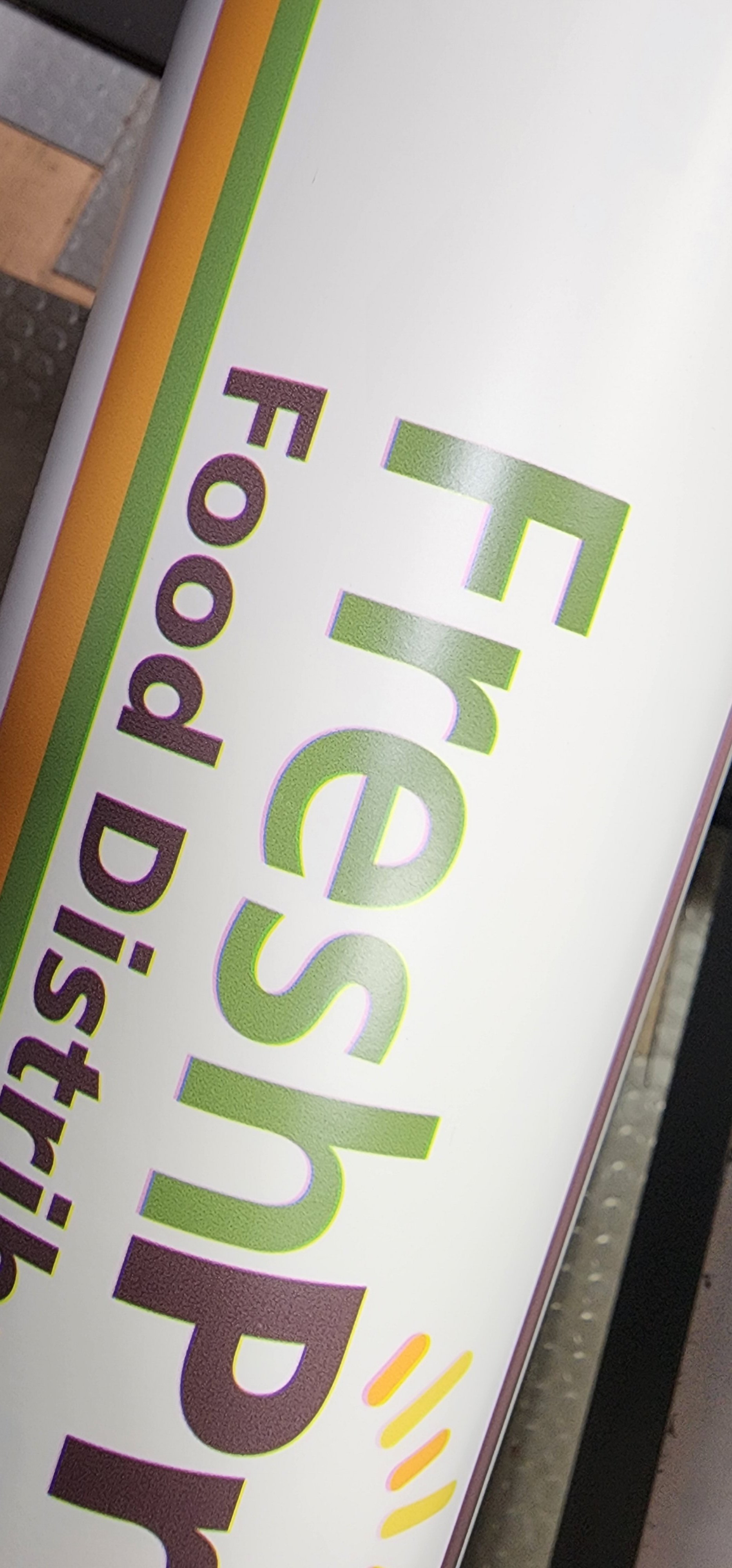

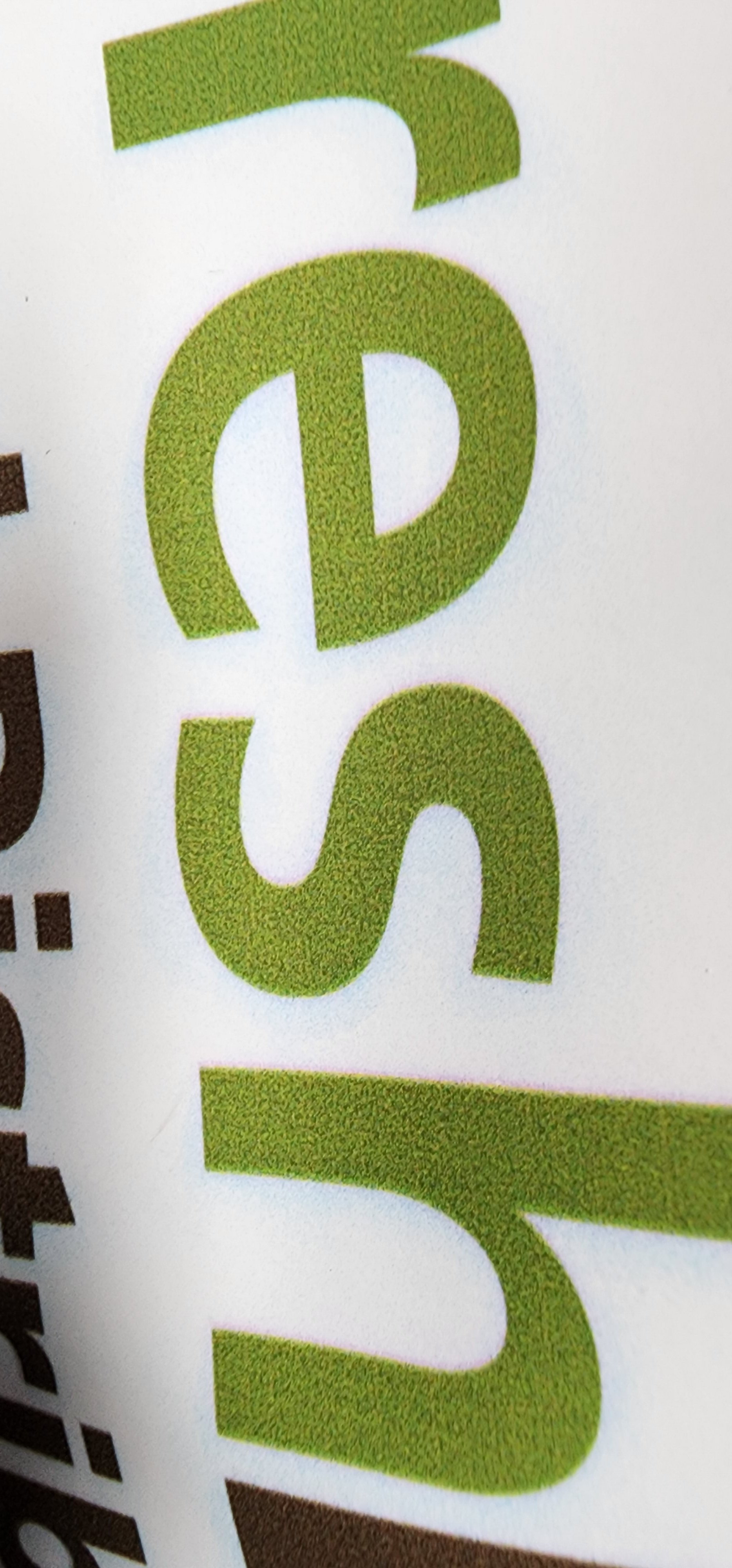

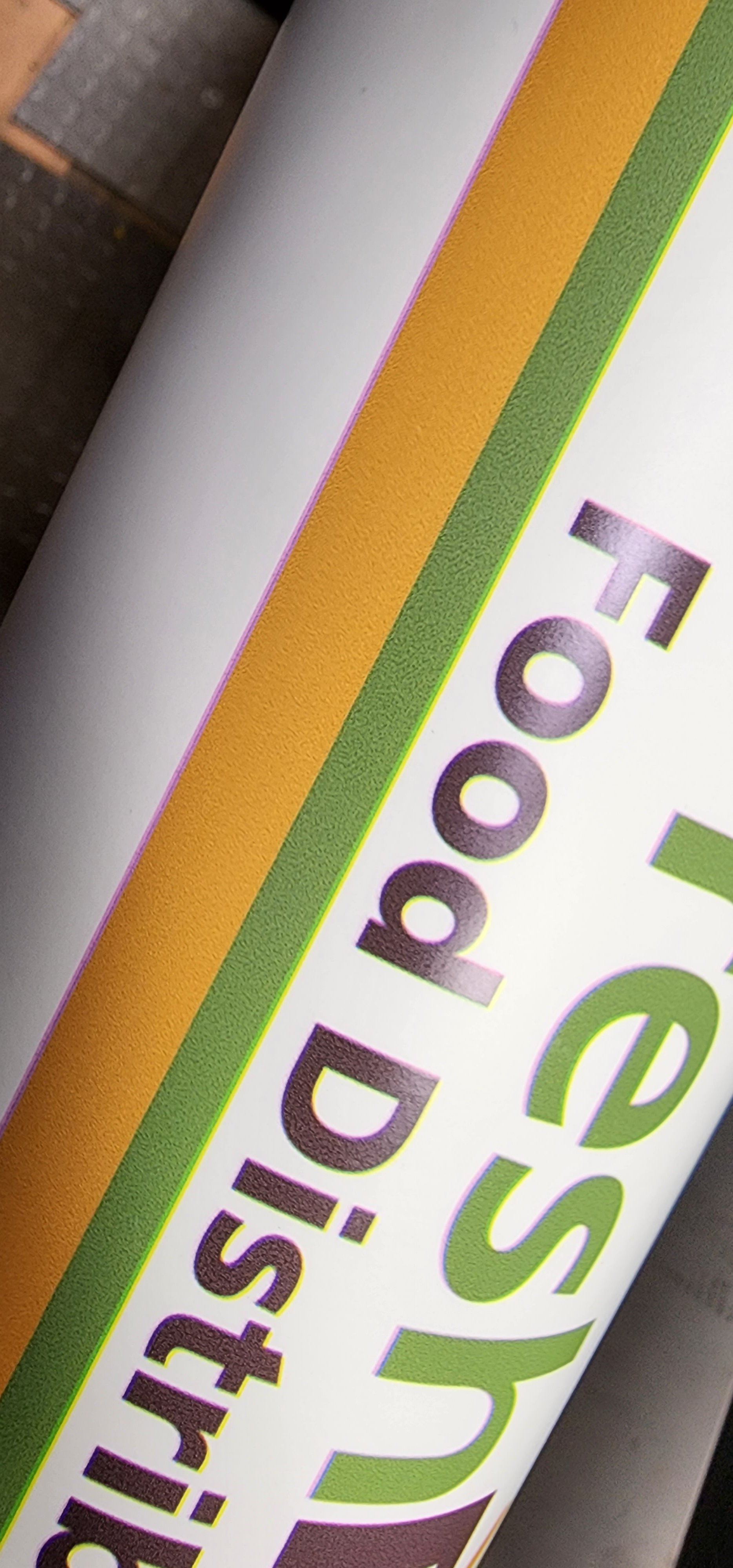

Having issues with printing on both units.
On 1st xc-540 pro III the Heads are all firing correctly but seems I'm getting separate color shadow as shown in pics.
On the 2nd I have blue cast or glow around everything almost always. Same thing, heads are all firing correctly.
Anyone know what What would cause these issues?

cornholio
Nozzle test and printing direction would be helpful. One looks like bad adjustment or carriage crash, the other like printhead needs replacement.
anthonyd969
I will post a nozzle test tomorrow. Thanks for the info. I did have a carriage crash which broke the media clip. That's the fuzzy image.
