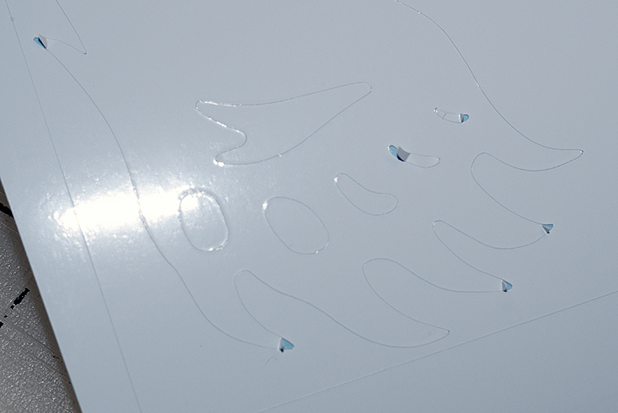

Question What would cause these bad cuts on a Graphtec CE6000-60?
phototec
When the cutter cuts around the sharp corners, it is lifting up the 751 vinyl. I have slowed the cutting down and it's still doing it.
Has anybody seen this before and what did you do to correct it? Thanks in advance.
CanuckSigns
Is the knife sharp? A dull knife could cause this. I would also put a small radius on those corners prior to cutting, it will help them cut smoother and they will be less prone to lift when applied.
Small Lettering
SmallLettering.com
Usually when I get this on my Summa T, it's because a small piece(s) of vinyl is stuck to one or both of the small rollers on both sides of the tip of the blade.
BetaCtz
What blade angle are you using? I find a 45 cuts better than a 60 degree blade on any 2mil cast.
As previously mentioned
- blade depth
- cutting strip is good in those areas?
- slow down cut speed
- loose vinyl bits stuck around blade area
phototec
You guys are AMAZING, I took the blade holder apart to install a new blade and there was a small piece of vinyl inside, I guess it was keeping the cutting blade from turning. Anyway thanks to all how came to my rescue. This could help others who experiance the same issue.
I was using a 45° blade on the Oracal 751 cast vinyl.
