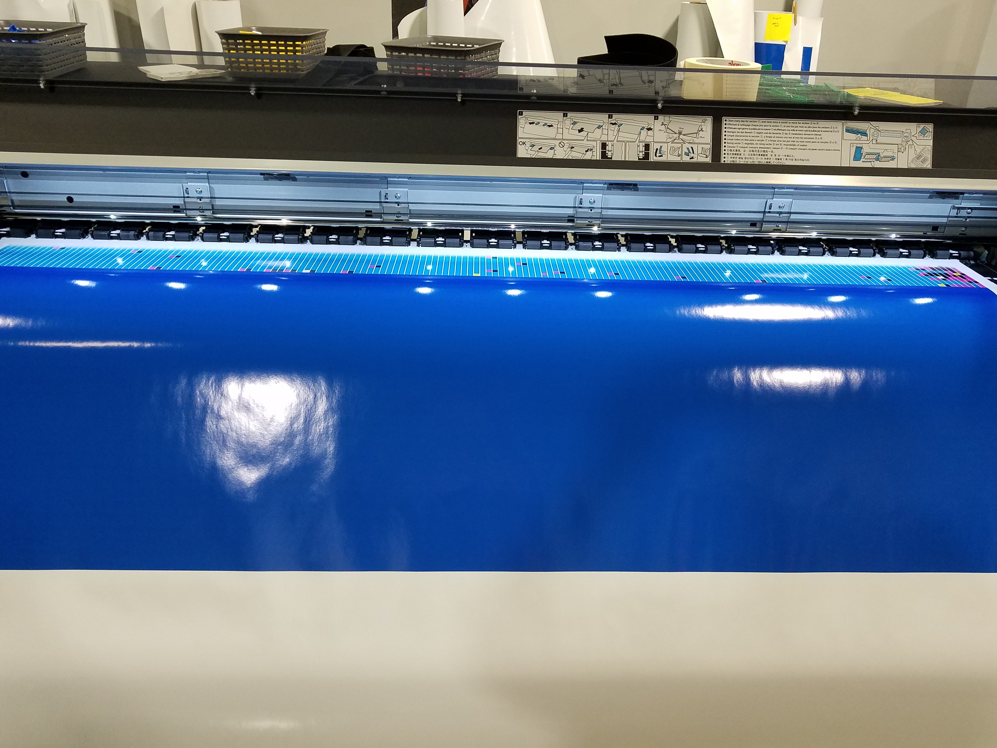

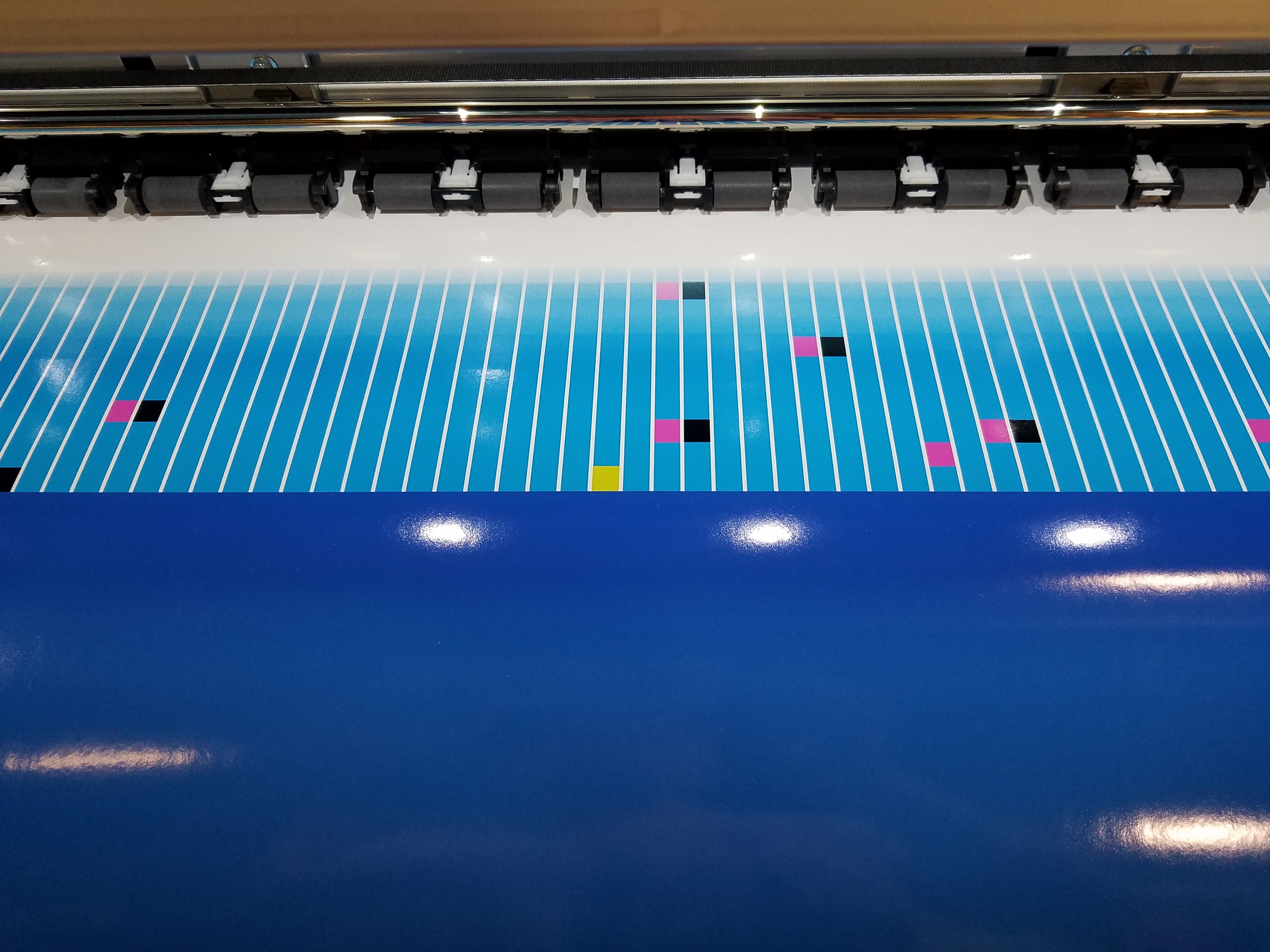

What would cause this on an Epson S80600?
mkmie
Lost Soul
Printed hundreds of panels of the same material in the same way and then boom, this happens.
Solventinkjet
DIY Printer Fixing Guide
I don't work on Epsons very much but if I had to guess I'd lean towards a processing failure. Either on the RIP end when it was ripping and got corrupted somehow or the processor on the printer glitched and corrupted the data. What happened when you tried to start printing again? Did it go away?
mkmie
Lost Soul
Yep, printed four panels after that one with no problems. Holding my breath now. Glad I was walking by right when it started or could have lost a lot more material and time.
