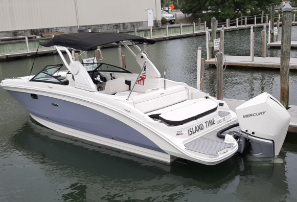

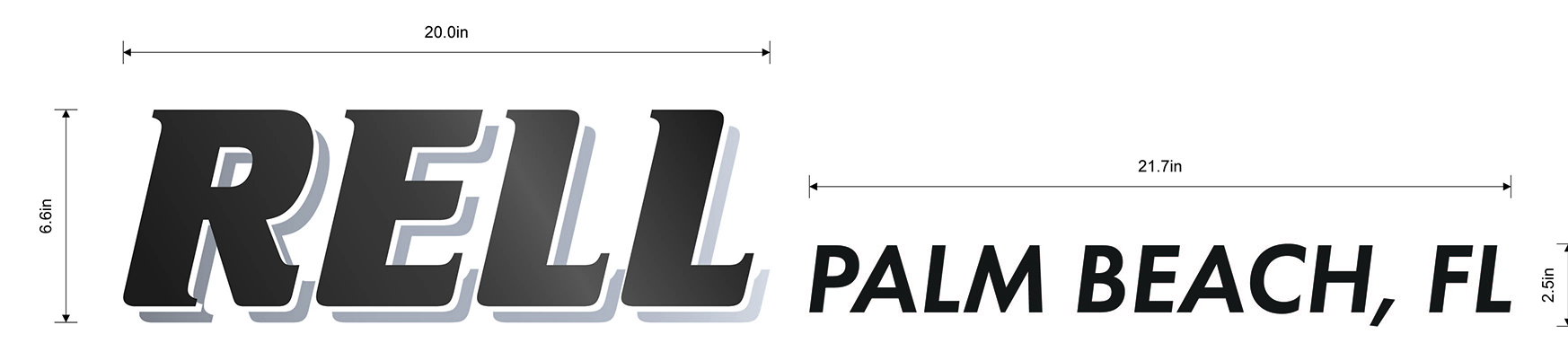

For some reason this particular job irks me so this may be more of a rant than anything. I felt like we quoted this a little low at just about $200 to design, print, laminate, cut, and install on this boat. He wanted to replace Island Time with the new name of his boat. He had already removed the vinyl and stated that the surface was clean. The boat would be on a trailer in his driveway about 11 miles away from our shop. We quoted it using Oracal 3551 with 210 laminate (we should have quoted it for 290, which is what we would have used, but someone dropped the ball on that) and 951 for the text reading "Palm Beach, FL".
He stated that our price was way out of line for such a simple job. What would you have charged?
Normally I just ignore this kind of thing and move on - but for some reason I keep thinking about this. Is $200 way out of line for someone to create and print you custom graphics on materials that will handle the sun exposure that a boat is going to have, drive to your location and install them correctly on your boat?

This should all be cut vinyl and not printed. Second, 210 is not even specd to be used with 3551 and is garbage laminate IMO. For what he got, I kind of have to agree with him.

That looks like a fairly nice looking boat, $200 seems more than reasonable.
Send him to the DIY section of Home Depot, they have some nice reflective aluminum backed mailbox letters for only $4.50 a set that should suit him.

He wanted the print to get the gradient effect and as I said in the post, we would have used 290. While his estimate did have "210" listed on it, I genuinely doubt he has any idea what that means. We use 210 for general signage (realtor signs, etc) all the time and don't find it to be garbage.

Looks like a nice boat, reminds me of when someone came in to our shop to ask about getting something engraved as a gift, scoffed at the price and tried to wear me down, then left and drove off in a $100,000 Mercedes SUV.

Look on the tech sheet for 3551. 210 is not a compatible laminate.

We do about a half dozen boats a week in season, or more. That boat should be done in cut HP vinyl, not printed. It would be priced at our flat rate, $250 plus tax. Nothing about it to add to the price. If there is vinyl or adhesive removal, that starts at $30. We are located about a half mile from the water, but it's a big lake. We charge more if the boat is outside our local area (more than a 15 minute drive one way).

I know it's a dumb questions, but what software did you use to apply dimensions on the image?

That seems cheap to me unless they provided the graphics file and you are next to the install location or they came to you. You should have a print-cut minimum and install minimum to protect you from leaking money on jobs like this.
Second, why wouldn't you print-cut the whole thing? You're adding labor to the install as well as production by creating multiple pieces on 2 different machines.
