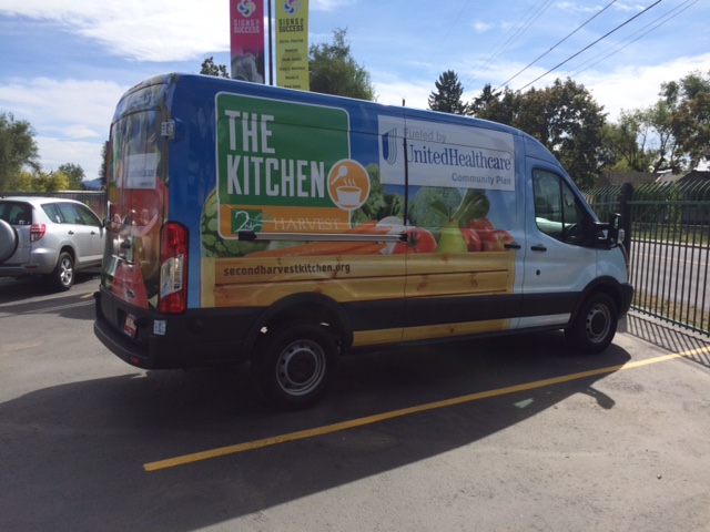

Last month we did a couple of 2015 transits at $3,500 each. You said you were doing a passenger van so if there is Perforated window film involved it would obviously be more expensive. We in general are in the $8.00/sf $11.00/sf installed. A fleet of Semi Trailers with FRP sides and no rivets could get below that range and a VW bug would be over that range because of the time required with all the compound curves.

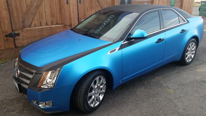

$3,500 is also the price to do a Caddy color change like this one on personal daily driver. took it from glossy black to satin pearl celio blu with carbon fiber accent and some embossing

Dude, that Caddy looks nice. Forgive my naivety, but how do you get that embossed look? Never seen that when it wasn't a cool printer trick.

I totally agree, looking REAL good. But what is the embossing? Never seen that before, his is that done? :thankyou:

We do a lot of wraps but mine always went to the bottom of the list because I'm not a paying customer (cobblers kids shoes). So some of the guys came in over the weekend last a couple of months ago and got it done. We used Avery Giovanni Edition Satin Pearl Cielo Blu with 3M carbon fiber and logo embossing we used 12mil motomark from General Formulations. The motomark laminate we mounted to Avery 1005 prior to plotting so when we remove it we won't be fighting the laminate adhesive. 12 mil might have been a little thick, but looks good.
