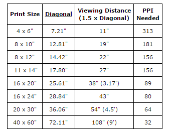

There are many charts available online. It really depends on what your printing, and more importantly the viewing distance. I've attached two that I found with a quick search.

As pointed out by others, the charts I provided were PPI - what your file setup should be within your image editing software. Printer resolution (DPI) should always be higher. For me this is easier to determine with a hands on approach by printing samples. With most wide format machines there will be other settings that change with DPI, like number of passes, that can also have an effect on the final output.
