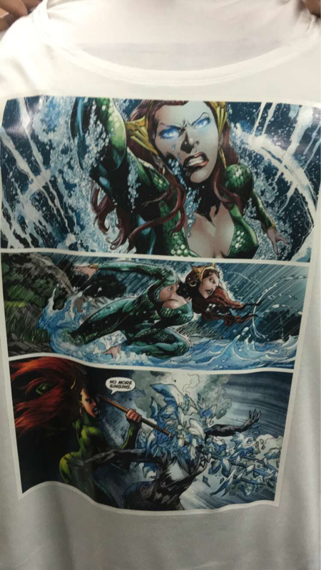

Heres a shirt i did for a friend

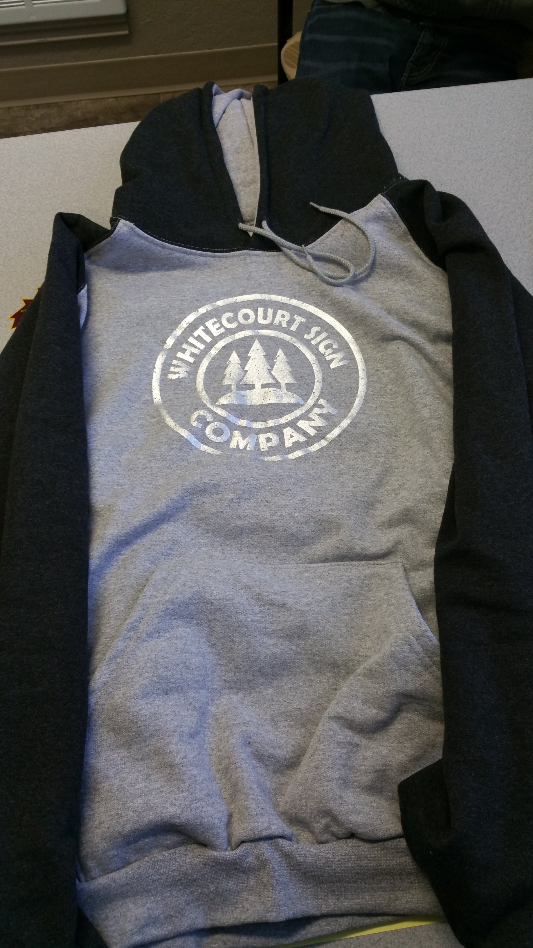

I do a lot of shirts and we are also set up to screen print but the best materials I have found:
Siser Colour Print (amazing stuff, softer hand than the Stahls stuff, lasts better than 50 washes and weeds like a dream from my mimacki)
My new favorite is Forever Digital Transfer
this stuff is more costly than heat tranfer but the results are pretty amazing especially the foil and the hand is soft. I have a hoody I did to test it in silver foil. I have been wearing it a couple times a week for about 6 months.
