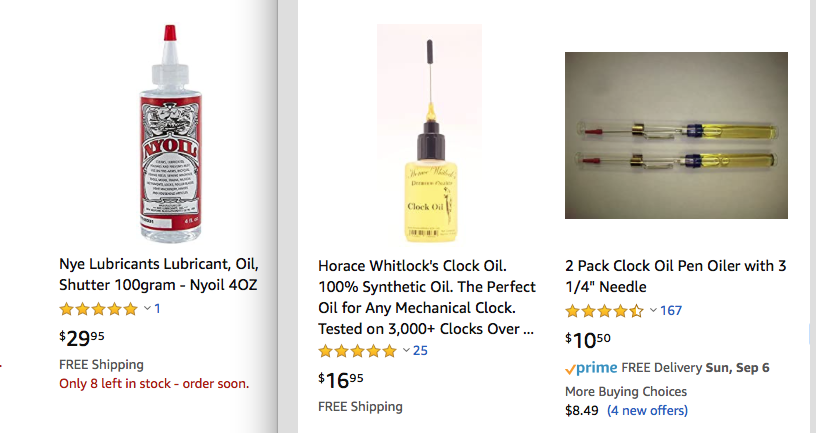

As matter of Fact it is NYE OIL.
You can get a 4 oz. bottle off amazon for like $30
You can buy a 6 oz bottle from HP for $90
Again it is Nye Oil.
Has an interesting History Google Nye Oil
interesting read.
